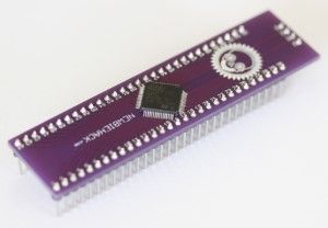

For an end of study project, I use a STM32L073RZT6 MCU.
I made an STM32 / Breadboard adapter. Like that :
Now, I would like to program this MCU. For this, I was given a ST-LINK / V2.
