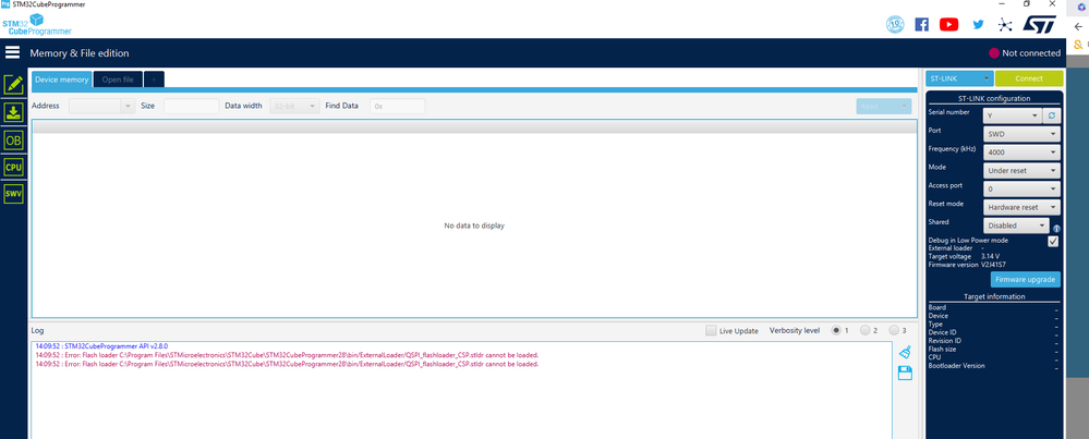

I have bought a new st link / v2 A 2022 08.
I am able to program my microcontroller with stm32cubeide as shown below
but when I try to program it which the same version of stm32cubeprogrammer I am not able to do it..
I click on connect but nothing happens..
Which are the differences with the previous st link h?

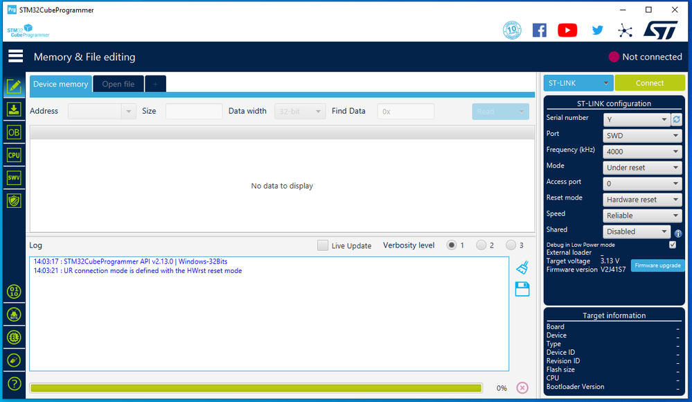

Hello @SGasp.1​,
Could you do the same test with the latest STM32CubeProgrammer release (v2.13)?

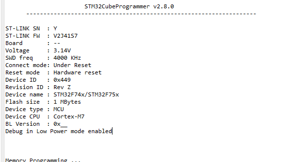

It probably doesn't work with the newer version either, so you can assume that your ST-LINK/V2 is a fake from Asian production. You can already tell from the serial number, which only gives a letter (Y in this case) instead of a real serial number.
The problem with such fakes has already been discussed very often in the community, e.g. here. The only solution is to buy an original ST-LINK/V2 from an authorised dealer, but you won't find them on Alibaba, Ebay or other cheap sellers.

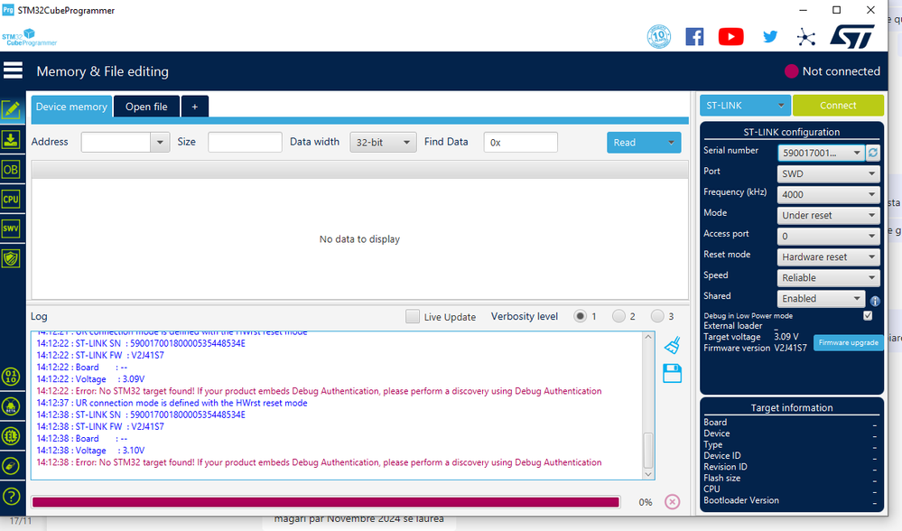

‎2023-05-16 2:34 AM - edited ‎2023-11-20 5:27 AM
Hi @Aziz BRIGUI​ .,. I will make an attempt.. Thanks
Here the result of the update
Any idea about the issue?

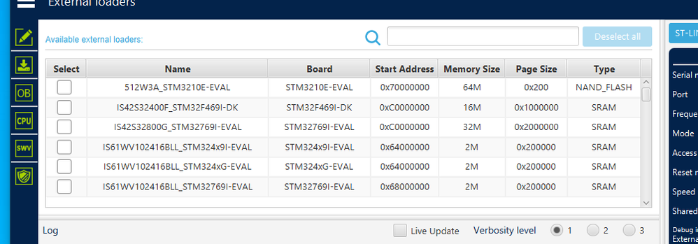

I was able to read the flash by changing the shared option from disable to enabled (using 2.13 version)
Now I want to try to download the fw but I have also an external loader too named QSPI_flashloader_CSP.stldr . I have added my custom bootloadr inside the externalloader folder under the 2.13 directory but i am not able to see it in the gui .
What could be wrong ?

You mentioned neither the version number of the STM32CubeIDE nor that of the STM32CubeProgrammer, so nobody knows.
Of course, new software is also adapted to detect and drop support for fakes - STMicroelectronics cannot take responsibility for fakes/counterfeits.
‎2023-05-16 4:54 AM
Hi @Peter my intention wasn't to buy a fake product as you can imagine.
Now that I realized these kind of problems I will be more updated.
STM32CubeProgrammer not working is version 2.8
STM32CubeIde working is version 1.7.0
‎2023-05-16 4:59 AM
Both are completely outdated, please get the current versions for STM32CubeIDE and STM32CubeProgrammer, as already mentioned by @Aziz BRIGUI​.
