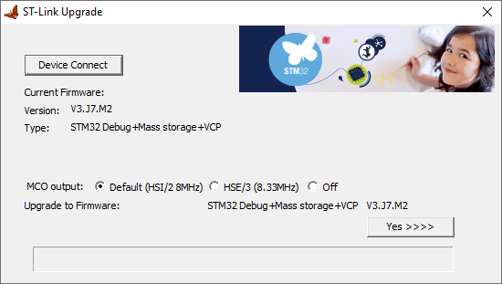

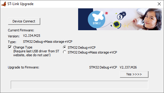

So latest ST-Link firmware, STSW-LINK007 - but: it works only for ST-Link V2, not for ST-Link V3. Firmware for V3 does not have this 'type' option.
So, for a NUCLEO-H743ZI (old one, with V2) I can do firmware without USB storage, but for NUCLEO0H743ZI2 (newer board, with V3) - not possible (missing this option).
So, not really consistent and issue still open.
NUCLEO-H743ZI (old, V2)
NUCLEO-H743ZI2 (new, V3)
==> Please, is there a ST-Link FW Update for version V3 with the same option to disable the USB storage device?

For ST-Link V3 it does not seem to be supported and provided before 2021.
Ok, so we had to stop using the latest NUCLEO-H743ZI2 boards (or all boards with ST-Link V3 chip on it).
