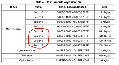

13 REPLIES 13
This worked for me...
  • The same error, when using ST STD PERIPH library specifically to erase flash sector 4 on NUCLEO-F446RE dev.
  • One more observation is the issue doesn't happen when all the sectors in the range 4-7 are erased.
This worked for me! Thanks for the explaination. 1s deday sufficed for me.
Also, debugging without reflashing also works, but it implies that you can't modify the code you're trying to debug, which is cumbersome to say the least.
Thank you for explaining, this solved my issue too. Can someone fix that answer?
