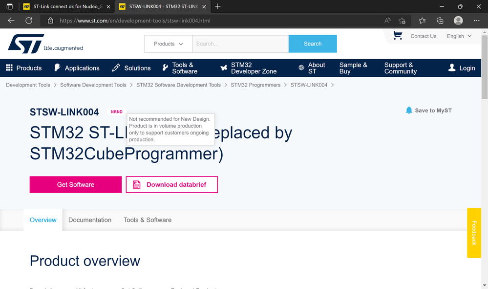

ST-LINK UTILITY does not support G491.
Please try to use STM32CubeProgrammer.
https://www.st.com/en/development-tools/stm32cubeprog.html

What a surprise, you are right ... CubeProgrammer works nicely, and also Keil uVision.
Thanks a lot, this made my day... .
(But it's a BIT nerving, that there seems to be no comment about this "strange behaviour" in the documentation, neither in STM32G491 datasheet, nor in STM32G4 reference manual / at least I did not see anything...).
