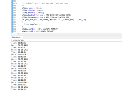

I have setup the RTC LSI on the board and got the serial print date and time. and now i wanted to get the RTC LSE clock and serial print clock values. i configured the clock configuration in LSE by following the same steps as i did in LSI, but it didn't work. It prints like this.

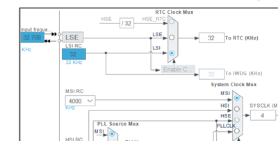

First, i will initialize the time and then the clock is set up and the count continues. It will show up on the serial monitor of the CubeIDE. This one I have done this by enabling LSI on the clock configuration. Now I wanted to do it by enabling LSE. The reason I can't use LSI is because there is a time shift in the LSI and I hope that there is no time shift it LSE.
Here by I have attached how I did in LSI and I wanted to do similarly in LSE
