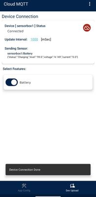

I'm a novice and I've never used an STMicroelectronics component before.
I just downloaded the ST BLE Sensor application to connect to my SensorTile.Box Pro.
It recognizes it and everything seems fine so far. I also noticed that there's an option to connect it to a Mosquitto broker, so I entered the URL, port, username, and password, also selecting the features it should send.
I noticed that the topic is deviceid/Features, so I created a new node on Node-RED to visualize the data. The app ST BLE Sensor tells me that the connection to the broker was successful, but I'm not seeing any data on the dashboard. Can anyone provide me with some further clarification?
Thanks :)

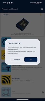

Hi Nathan, thanks for the answer, i am running the STSW-MXBOXPRO entry/expert Mode v1.0.0 with  stsw-mkboxpro-fs as software i was trying to only send the battery but nothing, i cant see nothing on nodered :(
And another think, if i try to create a new flow with this version v1.0.0 it say to me that

I don't know what happened to your battery info, but I'm sure that the battery info loads really slow.
It's important to renew your firmware. The firmware FOTA update is available on Android Apps.
I have an iPhone and a Huawei Mate 10, but firmware update seems to be unavailable on iOS...
With an Android, it worked perfectly.
So why? That's because iOS has a secure function which disabled the firmware download and upload, as well as the json file distribution on the board. However an Android has an open file system which supports the BOX's firmware.
There are two choices for you to load the latest firmware:
1. Buy an Android phone to load the firmware through FOTA.
2. Buy an official ICP (i.e. STLINKV3-SET) for the board, and download the board's SDK. Program the board with the latest firmware using the ICP (skip FOTA , force download, however you need to open up the BOX using a screw).
