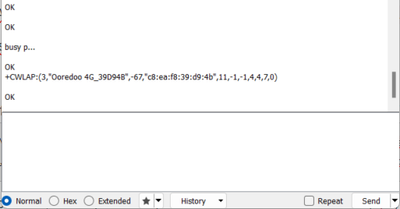

I’m currently working on a project where I’m using an STM32H7B3I-DK board to communicate with Esp8266 WIFI Module using AT commands. I’ve been able to successfully send commands and receive responses using HAL_UARTEx_RxEventCallback , but I’ve encountered an issue with the AT+CWLAP command.
When I send the AT+CWLAP command, On my Serial Port I receive this :
But in my Rx Buffer the first few characters of the response are missing. Here’s an example of what I’m seeing:
\r\nOK\r\n", '\0' <repeats 30 times>, "Ooredoo 4G_39D94B\",-67,\"c8:ea:f8:39:d9:4b\",11,-1,-1,4,4,7,0)\r\n\r\nOK\r\n", '\0' <repeats 1943 times>
As you can see, the response begins with a series of null characters (\0) and the first +CWLAP: is missing.
Here are some things I’ve already tried to resolve the issue:
  1. I’ve disabled the echo of the AT commands using the ATE0 command.
  2. I’ve checked the UART baud rate and it matches the baud rate of the WiFi module.
  3. I’ve tried both Normal and Circular Mode.
Despite these steps, the issue persists. My Code is the following:

I think this probably has to do with this circular buffer implementation. The missing characters at the beginning of your received response suggest that data might be getting overwritten before it's properly copied into your circular buffer.
I have had something like this in the past. This code below is doing the same thing you want to do. I had a bluetooth module interfaced over UART. This can be a possible solution for you, perhaps?
Important, in my case, I am receiving data byte by byte. I am assuming from your code that you have a data block that is being received.
