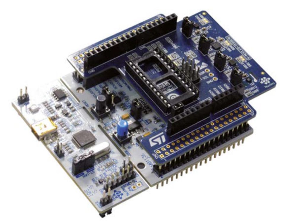

Still not clear. Can you, please, clarify what you mean under stacking (independently of complexity of custom board):
  • Nucleo-64 [male] <--- (morpho con) --- [female] Custom brd [male] <--- (morpho con) <--- [female] GFX01M2
  • Nucleo-64 [female] <--- (Arduino con) --- [male] Custom brd [male] <--- (morpho con) <--- [female] GFX01M2
  • something else
Here is an example of stacking on the Nucleo motherboard: the expansion board goes into morpho con, but the next board is supposed to be connected to Arduino con.aaaa.JPG

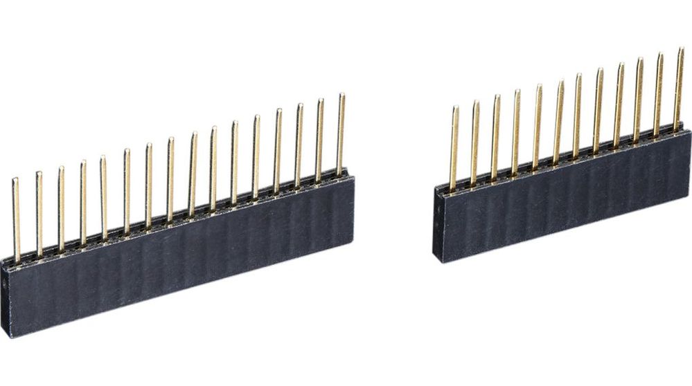

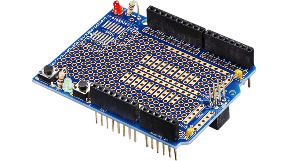

The only header that I can find for stacking purposes looks like this (Adafruit):
In assembly it looks like this:
Does anyone know of similar products from other manufacturers?
