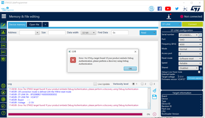

Error: No STM32 target found! If your product embeds Debug Authentication, please perform a discover
younginpark
I am using the STM32F407IGT6 chip. However, when I connected JTAG, the symptoms shown in the picture appear. So I have completed the VDD or continuity test. Can you tell me the circuit diagram and the reason?
