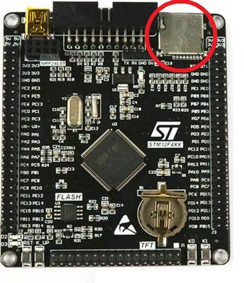

hi, community!
I need to use SDIO integrated into Stm32f407VET6 BlackBoard I followed two videos on youtube and always gave me the same problem  res=f_mount(&fs,"",1); always gives me FR_NOT_READY I asked Gemini and he told me to change it to   res=f_mount(&fs,"",0); when I change it the function return FR_OK but the rest of the functions not work like  f_write f_read are return FR_NOT_READY
I found someone in stack overflow has the same problem but without solution
I hope you can help me

Need to debug at the DISKIO level. Is it failing due to a Card Detect pin on the socket?
I think you are talking about an external module. if I'm wrong tell me,
I'm using the SD card integrated into stm32 Blackboard
One of the main reasons for FR_NOT_READY is not implementing the card detect switch on the SD Card socket, or handling it improperly. It's going to be a GPIO, checked in DISKIO.c layer.
You're not going to be able to debug FatFs via top-level code and errors. You're going to need to debug the DISKIO and SDIO layers. Would suggest instrumenting (messages to a terminal) so you understand what's happening and failing.
Don't write or format cards until you have reading working flawlessly. The cards come formatted, so should rarely, if ever, need f_mkfs()
I am facing the same issue. I think is it due to the CD pin. In the schematics of this board, the CD pin is connected to GND. I am not able to bypass this hardware check by diskio changes. I am returning 0x004 in disk_status by default but still f_mount doesn't return RES_OK at the end. When I looked on the board's website they said it's easy to get around this CD issue by some software changes but I am not able to find out what to change. Whatever I change, the board hangs for 10-15 secs then returns faults.
