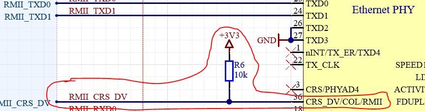

we have a PHY with several bootstraps. Some of them are shared with the RMII from a STM32H753 (see image below, controller is on the left).
0693W00000Hred2QAB.pngA FreeRTOS+TCP network stack is used, which, when rebooted, first does some low level inits with HAL_ETH_Init(), an then resets the PHY (to do some other configs).
My concern is the following: What happens to the RMII responsible GPIOs (like RMII_CRS_DV) after HAL_ETH_MspInit()? I fear that there might be some undefined logic level, which interfere with the pullups/bootstraps, thus putting the PHY into a wrong config. The problematic pin PA7 (=RMII_CRS_DV) is configured like this in HAL_ETH_MspInit():

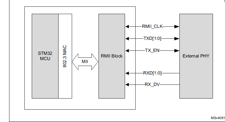

CRS_DV is a receive pin and an input on MAC side. Therefore it will not overpower the level set by R6 pull-up resistor.
Thanks for your reply. I'm just kind of confused, since the GPIOs are configured as push-pull. But according to the datasheet of the H7, you are right:
