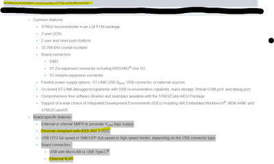

I have seen on the website that the NUCLEO-U575ZI-Q board includes Ethernet RJ45 (under the Moard-specific features): https://www.st.com/en/evaluation-tools/nucleo-u575zi-q.html
However, it doesn´t appear in the user manual (UM2861) and I can´t find the connector on the pictures, Is that a mistake or am I missing something? Thanks!
  • Board-specific features
    • External or internal SMPS to generate Vcore logic supply
    • Ethernet compliant with IEEE-802.3-2002
    • USB OTG full speed or SNK/UFP (full-speed or high-speed mode), depending on the USB connector type
    • Board connectors:
      • USB with Micro-AB or USB Type-C®
      • Ethernet RJ45

I agree. I suppose it is a mistake (copy paste).
jiangfan
August 28, 2023
NUCLEO-U575ZI-Q is one of the STM32 Nucleo-144 board. Ethernet RJ45 is available on part of STM32 Nucleo-144 boards, but it is not available for NUCLEO-U575ZI-Q.
Peter BENSCH
August 28, 2023
The STM32U575 does not contain an Ethernet MAC, apparently the data on the website was unfortunately not checked closely enough before publication. The details mentioned in DB3171 and UM2861, on the other hand, are correct. We hope that the website will reflect the correct data as soon as possible.
