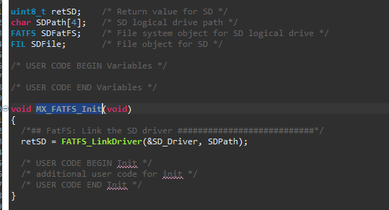

 I am encountering the FR_NOT_READY and FR_INVALID_OBJECT error when trying to mount the SD card and write a file in RVT101HVSFWCA0 Riverdi display. Could you please advise on how to resolve these issues?

According to the examples provided under https://github.com/STMicroelectronics/STM32CubeH7/blob/master/Projects/STM32H745I-DISCO/Applications/FatFs/FatFs_Shared_Device/CM7/Src/main.c
I don't see that you linked the driver using  FATFS_LinkDriver().
  if(FATFS_LinkDriver(&MMC_Driver, MMCPath) == 0)

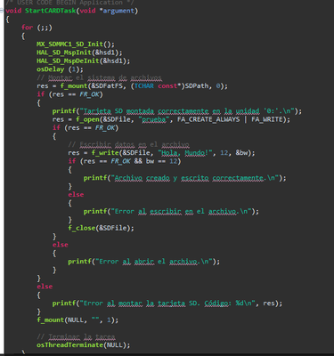

I reviewed the example you provided and corrected my code. The MX_FATFS_Init() function is executed before the StartCARDTask() function. Now I can mount the SD card but I still have the same error when using f_open() or f_write ().
Please use </> button to show your code instead of sharing a screenshots of it.
What errors you get for these APIs?
What if you use the same example (as it is) from what I posted and adapt it to your Hardware (clocks+IOs)? do you get the same behavior?
This is my code, I also tried your example and reconfigured the hardware but I still have the same error

void StartCARDTask(void)
	for (;;)
		MX_SDMMC1_SD_Init();
		HAL_SD_MspInit(&hsd1);
		HAL_SD_MspDeInit(&hsd1);
		osDelay (1);
		// Montar el sistema de archivos
		res = f_mount(&SDFatFS, (TCHAR const*)SDPath, 0);
		if (res == FR_OK)
			printf("Tarjeta SD montada correctamente en la unidad '0:'.\n");
			res = f_open(&SDFile, "prueba", FA_CREATE_ALWAYS | FA_WRITE);
			if (res == FR_OK)
				// Escribir datos en el archivo
				res = f_write(&SDFile, "Hola, Mundo!", 12, &bw);
				if (res == FR_OK && bw == 12)
					printf("Archivo creado y escrito correctamente.\n");
				else
					printf("Error al escribir en el archivo.\n");
				f_close(&SDFile);
			else
				printf("Error al abrir el archivo.\n");
		else
			printf("Error al montar la tarjeta SD. Código: %d\n", res);
		f_mount(NULL, "", 1);
		// Terminar la tarea
		osThreadTerminate(NULL);
	osDelay (10000) ;
If you tried the example as it is and didn't work, you need to check your SD card: it could be corrupted or not compatible.
I am using a type 10 SD card (10MB/s), which one do you recommend?
