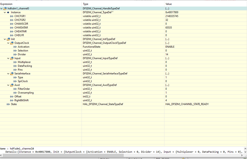

I tried to reset the DFSDM1 Peripheral for two days using the STM32H7A3ZI and STM32Cube FW_H7 V1.11.1 (If that's important)
I want to Change OversamplingRatio and RightBitShift during the run of my program.
Apparently you do this by calling:
MX_DFSDM1_Init();
if(HAL_DFSDM_ChannelDeInit(&hdfsdm1_channel0) != HAL_OK){
Error_Handler();
if(HAL_DFSDM_ChannelDeInit(&hdfsdm1_channel1) != HAL_OK){
Error_Handler();
if(HAL_DFSDM_ChannelDeInit(&hdfsdm1_channel3) != HAL_OK){
Error_Handler();
if(HAL_DFSDM_FilterDeInit(&hdfsdm1_filter0) != HAL_OK){
Error_Handler();
if(HAL_DFSDM_FilterDeInit(&hdfsdm1_filter1) != HAL_OK){
Error_Handler();
if(HAL_DFSDM_FilterDeInit(&hdfsdm1_filter3) != HAL_OK){
Error_Handler();
__HAL_RCC_DFSDM1_CLK_ENABLE();
__HAL_RCC_DFSDM_FORCE_RESET();
__HAL_RCC_DFSDM_RELEASE_RESET();
MX_DFSDM1_Init();
I tried to experiment with the CLK_ENABLE(); because another Post mentioned a possible Bug in 2021.
Without resetting and Deinit/Reinit my DFSDM with DMA works normally and it writes to the array, i start the DFSDM using this:
HAL_DFSDM_FilterRegularMsbStart_DMA(&hdfsdm1_filter0, getMainStorageCH1(), 40000);
HAL_DFSDM_FilterRegularMsbStart_DMA(&hdfsdm1_filter1, getMainStorageCH2(), 40000);
HAL_DFSDM_FilterRegularMsbStart_DMA(&hdfsdm1_filter3, getMainStorageCH3(), 40000);
the get Function return int16_t* to the Array. I use Oversampling of 512 and RightBitShift of 4
(but it shouldn't matter). No Error occurs when re-initializing, but the DFSDM doesn't write the Array

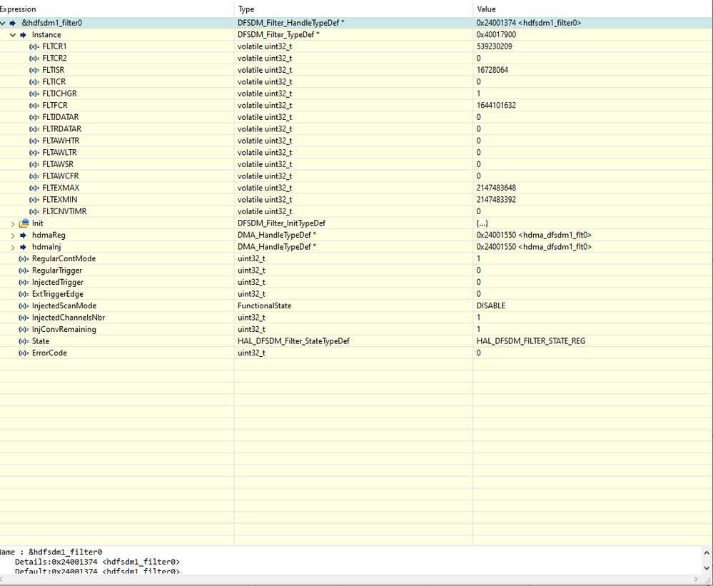

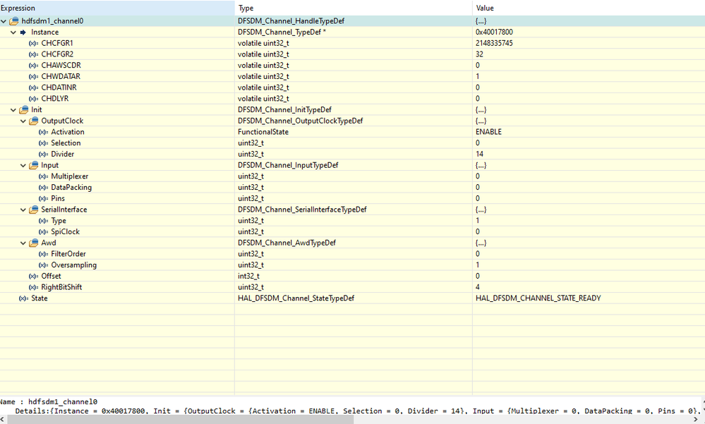

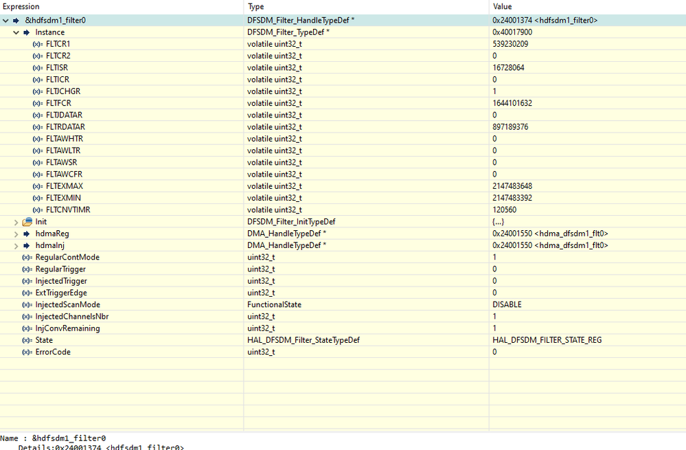

and doesn't fire ConversionHalf/Full Interrupts. I made Screenshots of the registers:
Channel 0 Without ResettingChannel 0 Without ResettingChannel 0 After ResettingChannel 0 After ResettingFilter 1 Without ResettingFilter 1 Without ResettingFilter 1 After ResettingFilter 1 After Resetting
Caption describes what was before and after Reset. I see a difference in some Registers but i dont want to spend days again learning the registers and how they work. Does anyone have a solution or is there another way to change Oversampling Ratio and Right Bit Shift without restarting the controller?
