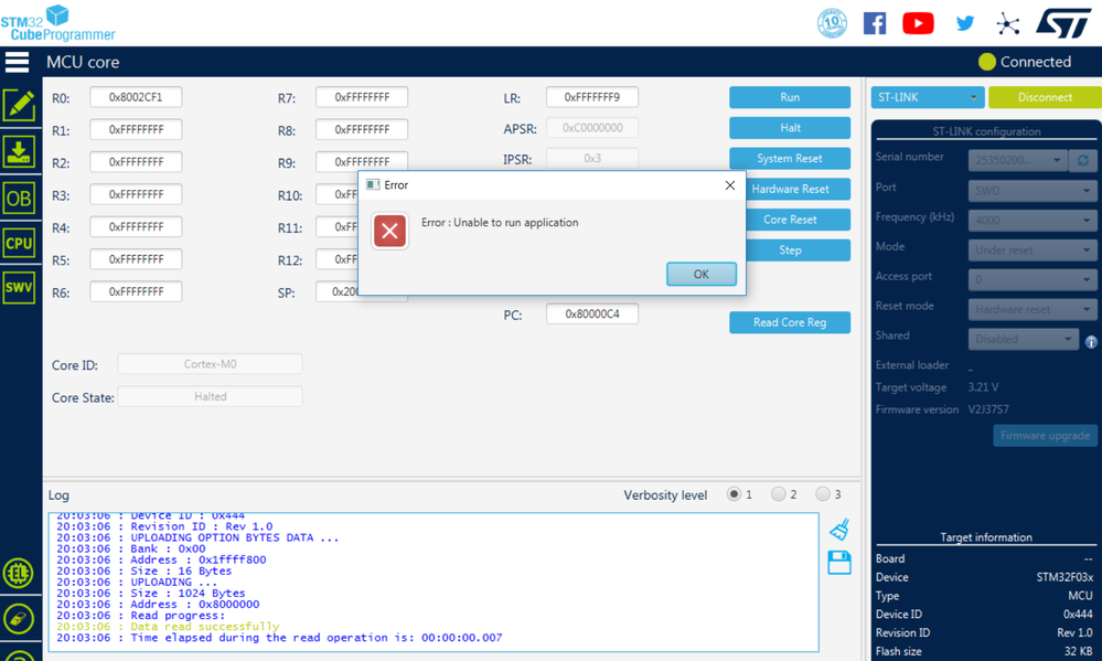

I do have 2 PCB boards based on STM32F030F4P6 MCU, the two PCBs have the same hardware and connection with other components, I read the first MCU's code using ST-LInk V2 -using SWD- and saved the .hex file to my PC then I wanted to re-program the other one with the same code, the programming proccess works well and the ST Link utility says that it success but when trying to run the code it says "unable to run"
what shall I do to correctly copy the same code? I program the flash memory and make sure that the Option Bytes are the same, what else must be copied to let the MCU work?

Copying the flash and option bytes is all you need to do. Do you have a screenshot of the "unable to run" message? You could try STM32CubeProgrammer instead.

Thanks for your reply, here is a screenshot
why do you prefer to use STM32CubeProgrammer? shall I also read the flash memory again with it?
I've tried STM32CubeProgrammer and when program it it says "Core is locked up"

I don't see a screenshot in your post.
STM32CubeProgrammer is newer and better supported. They do the same job, so sometimes one works and one doesn't. For older chips though, both should work. Easy enough to test.
There are a few hits online for "core is locked up" but no clear solution. Maybe decrease the clock speed.
If the flash is programmed, you shouldn't need anything to run the code. Just remove the ST-Link and power cycle the chip.

I'm not sure what "Run" in that box is supposed to do. Without a debugger attached, the chip will run on its own. Within STM32CubeIDE, you can also run the code. You don't need to tell the chip to run. Once you provide it power, it will run, assuming it's not halted from the debugger or in reset.
