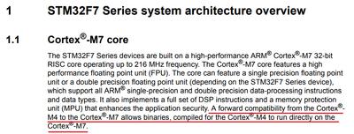

Is it possible to run on the M7 core a piece of program (subroutine call - no input, no output parameters) written, compiled and loaded for the M4 core (i.e. to have global access to program code)?

If you need a shared routine between the two cores (just an algorithm): theoretically yes.. But you need to do the test. Refer to the AN4667 / paragraph 1.1:

This is good beginning. The core of the question was about the following - do M4 and M7 cores share one and the same program memory (common address space) ? And if YES, if for M4 some address is 0x1000, is it the same for M7?

The flash memory is shared between the two cores and the flash addresses are seen in the same way.
