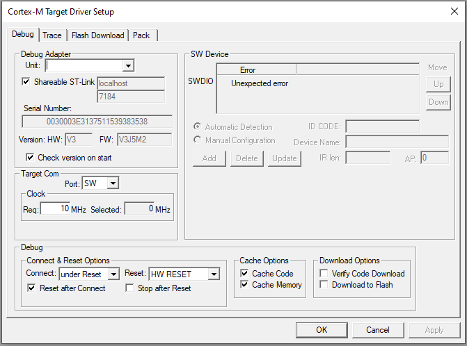

Hello to all, I'm trying to debug my multi core application. I'm following the AN5286 indication but I'm in stall soon, at "Shareble ST-Link"!
I'm using Keil ver 5.31 and the ST-LINK is with firmware ver V3J5M2. The problem appear with one project selected at once.

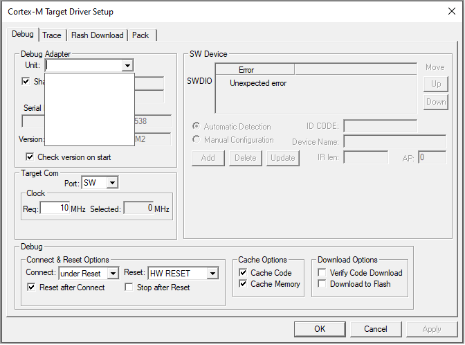

When I set the "Shareable ST-Link" flag the "Unit" popup became empty and the "SW Device" show "Unexpected Error". I attached the images.

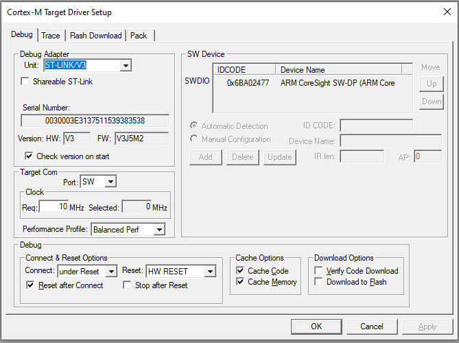

The STLink is visible:
The SW device is not present
The popup is empty too.

To use the "shareable ST-Link" option, you need to install an additional SW "ST-Link Server" from ST
‎2024-02-28 4:27 AM
‎2024-02-28 4:58 AM
Indeed as said by @storz-as you need to install ST-Link Server.
