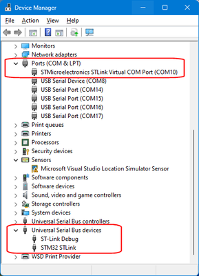

Is the VCP of the board visible on the host side (lsusb or device manager) ?

This board is brand new board, so the solder bridges should be default just like mentioned in the documentation. And sorry that I don't know what is VCP, could you please explain what do you mean by VCP is visible on host side?

VCP = Virtual COM Port - the USB-to-UART connection appears on the PC as a "virtual" COM port,
When you plug the board in to your host computer, do you see its "COM port" appear?
You haven't said what computer you're using, but on Windows it would appear in Device Manager; eg,
Sorry, I'm using MacBookAir M2, and I use CtoC cable to connect from my laptop to STLINIK USB-C port it looks like below, it is detected to be /dev/tty.usbmodem1103. And I use
