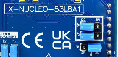

I'm working on a second project using AI and I came across the ToF sensor that can be used to detect hand gestures. It is possible to use the AEK-LCD-DT028V1 LCD together with the Nucleo-F401RE board and the X-NUCLEO-53L8A1 sensor.

The issue is not the display itself, but the use of the board together.

Again, look at the datasheets.
It looks like it gives a choice of I2C or SPI:
both of which are buses - ie, can be shared by multiple devices.
Sure, the stm32wb can do I2C and SPI.
