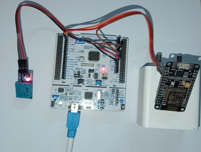

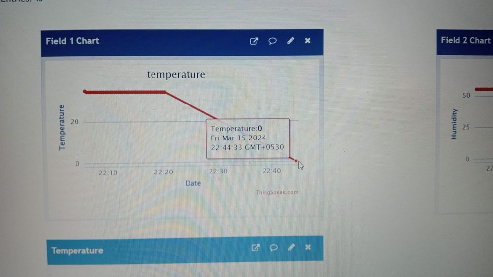

LG.5
Hii!
If i connect the DHT11 directly to NodeMCU its working fine and im getting values in Thingspeak
But if i try to send the data from NUCLEOF401RE to NodeMCU then null value is thrown in Thingspeak

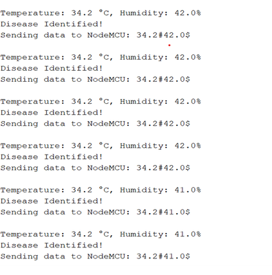

#include <DHT.h>
#include <Wire.h>
#define DHTPIN PA1 // Replace with the actual pin connected to the DHT11 sensor
#define DHTTYPE DHT11
DHT dht(DHTPIN, DHTTYPE);
void setup() {
Serial.begin(9600);
while (!Serial) {
delay(100);
Serial.println("STM32 DHTxx test!");
dht.begin();
void loop() {
delay(2000);
float humidity = dht.readHumidity();
float temperature = dht.readTemperature();
Serial.print("Temperature: ");
Serial.print(temperature, 1);
Serial.print(" °C, Humidity: ");
Serial.print(humidity, 1);
Serial.println("%");
// Check if temperature or humidity is high
if (temperature > 34.0 && humidity > 38.0) {
Serial.println("Disease Identified!");
// Send data to NodeMCU
Serial.print("Sending data to NodeMCU: ");
String data = String(temperature, 1) + "#" + String(humidity, 1) + "$";
Serial.println(data);
// Uncomment the next line if you want to send data to NodeMCU through Serial
// Serial1.println(data);
} else {
Serial.println("Conditions are normal.");
Serial.println();
delay(1500);
This is my DHT code

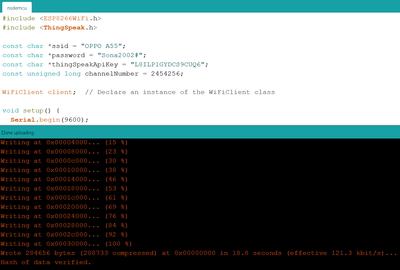

#include <ESP8266WiFi.h>
#include <ThingSpeak.h>
const char *ssid = "OPPO A55";
const char *password = "Sona2002#";
const char *thingSpeakApiKey = "L2UFGKXGO98IUE2S";
const unsigned long channelNumber = 2472082;
WiFiClient client; // Declare an instance of the WiFiClient class

void updateThingSpeak(float temperature, float humidity) {
ThingSpeak.setField(1, temperature);
ThingSpeak.setField(2, humidity);
int status = ThingSpeak.writeFields(channelNumber, thingSpeakApiKey);
if (status == 200) {
Serial.println("ThingSpeak update successful");
} else {
Serial.println("Failed to update ThingSpeak");
delay(1000); // ThingSpeak update interval (in milliseconds)
This is my NodeMCU code

So you've now fixed your problem(s) with the NodeMCU sending to Thingspeak?
So what debugging have you done to find where the problem is?
  1. Is the Nucleo reading the sensor correctly?
  2. Is the Nucleo sending the readings correctly?
  3. Is the NodeMCU receiving the readings from the Nucleo?
  4. etc, etc, ...
It looks  like you're using a UART on the Nucleo to send to the NodeMCU - yes?
If so, you can test that what the Nucleo is sending by connecting it to a PC terminal.
Similarly, you can test that the NodeMCU is receiving by sending stuff to it from a PC terminal.

Please give full details of how the the Nucleo is connected to the NodeMCU - a schematic of the wiring
