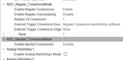

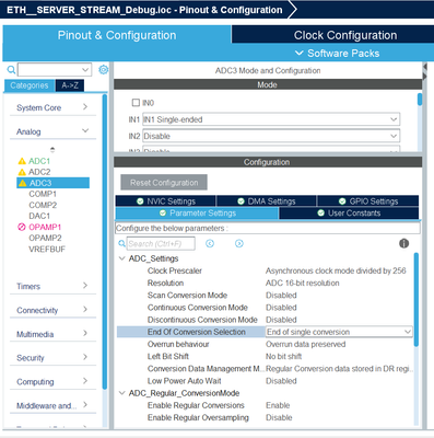

It is a regular conversion triggered by software, I should not even be launching conversions at this point.
I disabled ADC interrupts for the moment.
If it isn't running, what does "enabling" mean here specifically then?
There's no fundamental issue with running LWIP/Ethernet and ADC simultaneously, so the solution will likely be specific to your code/board/setup.
GLeje.2
"Enabled" means i simply enabled the ADC in the CubeIDE configuration panel. I uploaded a picture of my config below so you can see.
I indeed suspect there is something wrong with my setup but cannot pinpoint it.
I managed to make the ADC module work without problem in the past, so my best guess is that I messed up something with the LWIP.
