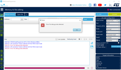

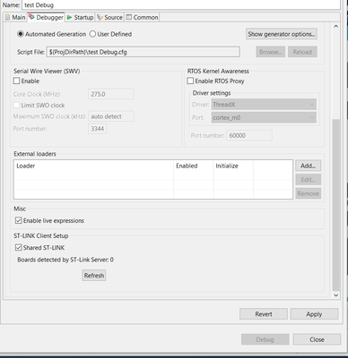

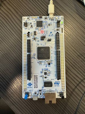

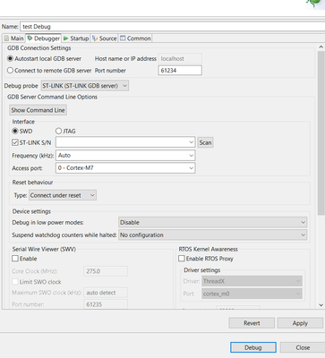

I have recently purchase a Nucleo-H7 board which uses the STM32H723ZG. I have tried to connect the board to my pc in order to flash it and it does not show up in either the CubeIDE or the Cube programmer. I am using windows 10 and all the drivers are updated. I have also tried the workaround I found here about manually copying libusb-1.0.dll to the stlink_server folder. I have installed the latest version of the Cube IDE, the Cube Programmer and all of the drivers needed. I have also uninstalled and installed both the CubeIDE and the prorammer, but still neither of them can detect the board.
I included screetshots of the debugging config and the programmer. also from the board. please let me know if I'm doing something wrong.

Make sure Windows is responding to the cable being plugged in and out and you can see the device in Device Manager. Unless seen there it's not going to be usable elsewhere.
Try a different cable. Charging Cables won't work if there's no data wires in them. Try other USB ports, avoid hubs and docking stations.

As @Tesla DeLorean said, check Device Manager - if it's not appearing there, then nothing else is going to see it.

Also it does in fact not show up in my device manager. so could that be a driver issue?
So does anything at all change in Device Manager when you plug & unplug the board?
If nothing appears its a cabling/power issue. The board could be bad. Don't put them on conductive surfaces, or short the pins in any way.
If it appears, but Windows can't associate the VID/PID with a driver, you'll get an instance on the tree with an Unknown or "!" type indication, and you can the associate a driver with it via a suitable .INF file and driver files.
