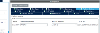

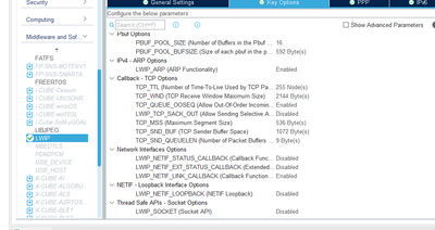

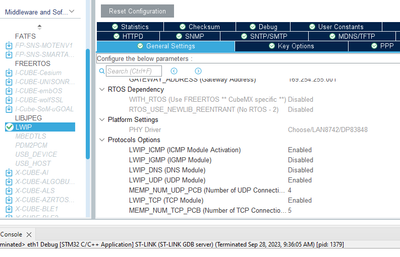

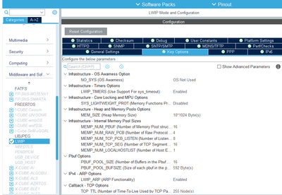

I am using Nucleo F746 eval board. I configured ethernet and lwip. But I can't get ping. "Reply from 169.254.255.144: Destination host unreachable." I get feedback like: My ETH and Lwip configurations are below. Can you help with this issue?

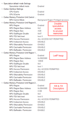

The STM32F746xx devices are based on the high-performance ARM®Cortex®-M7, for that it is recommended to configure cortex-M7:
  • Enable ICache and DCache.
  • Enable memory protection unit (MPU) in “Background Region Privileged access only + MPU Disabled ...” mode. Configure regions according to the picture below:
Could you please check the MPU configuration?

Unless he knows about cache handling, I'd say that turning OFF the caches would be the easier path for a start.
I use F746_Discovery, i follow your recomendation about MPU and LDCache, and the configuration before about LwIP. In the main.c i have added:

RMasi.19
i see the example LwIP_HTTP_Server_Netconn_RTOS the call LwIP are mixed with lcd and os function, i search some simple for start of CubeMX or .ioc, because these is the purpose of these graphical configuration, make simple the management of the pheriperal.
