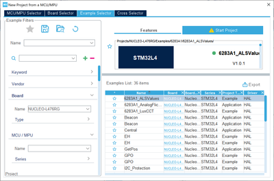

Also see the example selector in STM32CubeMX and STM32CubeIDE which lets you load them easily.
