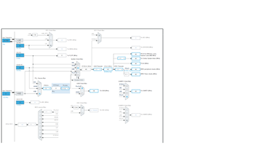

I am having trouble getting the USB peripheral recognized by the PC device manager.  In Cube I have the USB FS device checked, and the USB_DEVICE middleware set to virtual COM port.  Everything else is set to default.
The USB clock is set to 48MHz coming from the HSI48 source.
When the peripheral is connected to a PC (through a HUB) the device manager refreshes but the VCOM port does not show.

HSI as clk for USB might not be good enough.
Use HSE / crystal as source.
I changed from HSI48 to the PLLCLK at 48MHz without success.  Here is the clock mapping for reference.

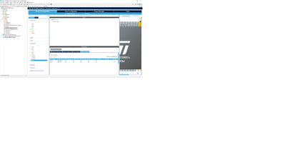

How you set the gpio pins for USB port ?
should be :  GPIO_SPEED_FREQ_HIGH;
GPIO are set to the default values, I don't see an option for GPIO_SPEED_FREQ_HIGH.GPIO.png
