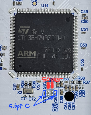

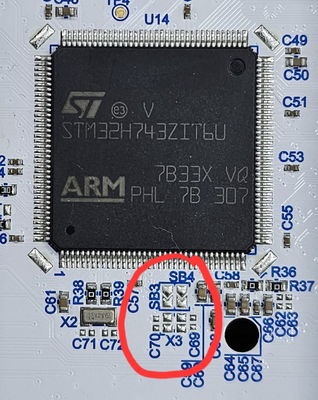

I use STM32 NUCLEO-H743ZI2 development board for my project.
I'm considering purchasing electronic components for the first time, and I would appreciate a recommendation for an X3 crystal that could be used in this situation.
Additionally,

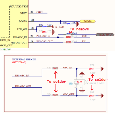

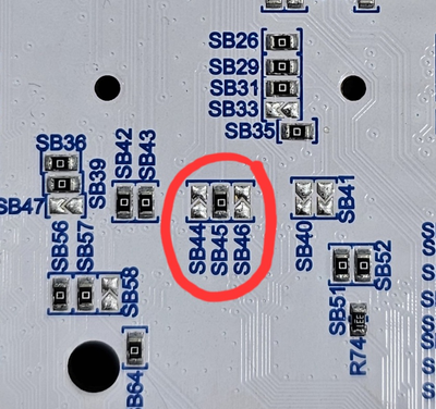

  • I understand that I should leave SB44 and SB46 as they are,
  • Solder and connect SB3 and SB4 each,
  • Solder 5.6pF capacitors to C69 and C70 each, and

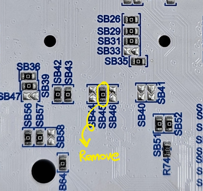

  • Remove the 0-ohm resistor at SB45, correct?
My board is currently in this state,
and I plan to solder as described in the following diagram.
Thank you very much for your guidance.

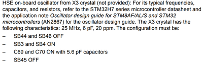

Hello @HMsDobby2 and welcome to the ST Community :smiling_face_with_smiling_eyes:.
For a recomendations about the X3، i suggest you to take a look at the bill of material file of your board. You will find the recommended part.

Thank you! However, can I just solder using the method I described? I'm a beginner and want to make sure.
Yes I confirm.
  • Leave SB44 and SB46 as they are,
This is based on the schematics:
