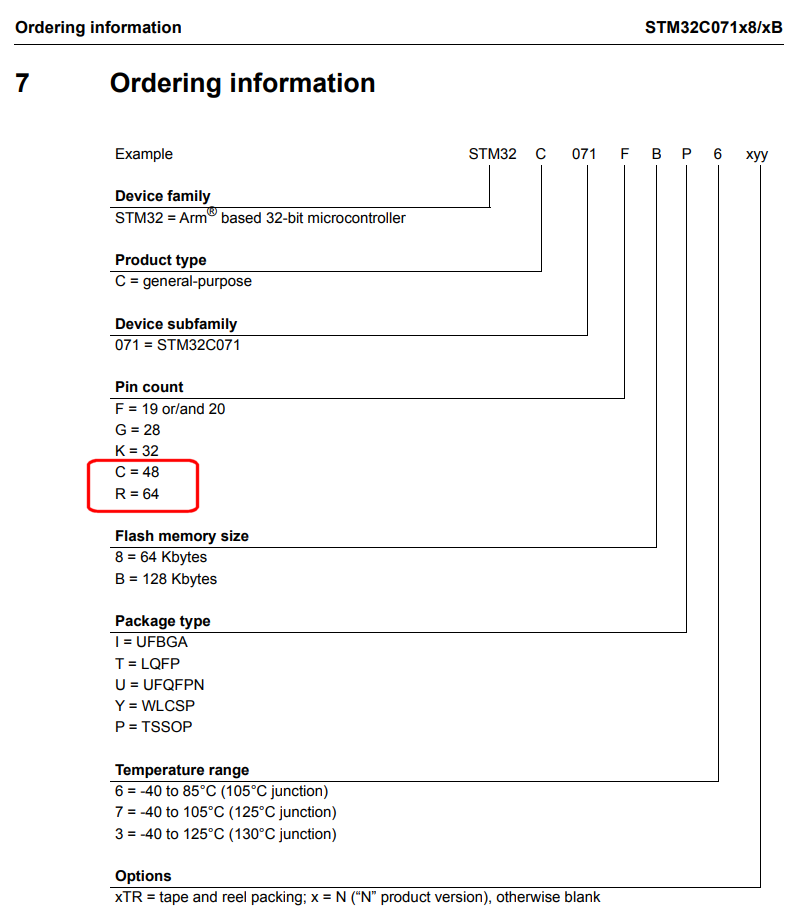

STM32C071RB vs STM32C071CBT6:
https://www.st.com/resource/en/datasheet/stm32c071rb.pdf#page=128
via: https://www.st.com/en/microcontrollers-microprocessors/stm32c071rb.html
So the only difference is in the number of pins on the package.
Therefore, so long as you restrict yourself to things which are available on both packages, the same code can run on both.

Hi Andrew and Imen,
Thank you both for your responses.
Let me provide a bit more context. I am currently using a development board (MB2046B) with an STM32C071RB, which is a 64-pin microcontroller. However, I intend to deploy the code on an STM32C071CB, which has 48 pins. To handle this, I have ensured that I am only using the pins common to the STM32C071CB by referencing its available pin names while developing on the STM32C071RB.
I generated the code and implemented the application layer accordingly. So, from a pin usage standpoint, I have limited everything to what the STM32C071CB supports.
My main question is: Will this code work as expected on the STM32C071CB? I am asking because I originally created the project by selecting the NUCLEO-64 board. Now that I plan to run the same code on a custom board with the STM32C071CB, I want to confirm if this approach is valid.
Please note: you can ignore pin mapping concerns — I have made sure all the pin selections are correct for the 48-pin device.
So, yes - that should work.
