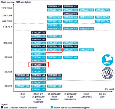

I would like to know if the use of the NUCLEO-L031K6 board is compatible with the STM32L021Fx MCU that I intend to use for a project of mine and in general if it is compatible with all the STM32L0x MCUs.

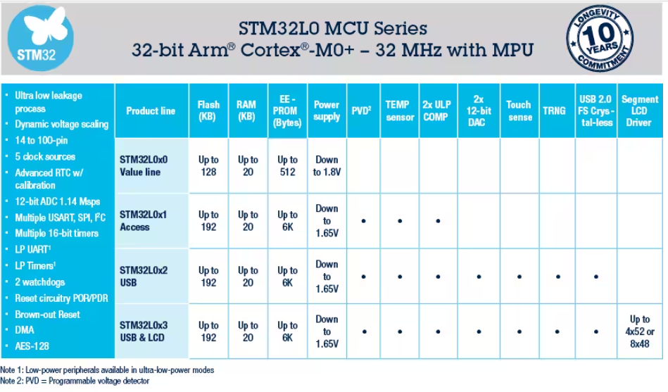

There you can see that the STM32L031K6 adds a segment LCD driver - which is not available on the L02x (or any other L0 parts). <-- See @Uwe Bonnes correction!
Other features which are common should be compatible - check the datasheets for particular parts to confirm.
No, both L021 and L031 are in the access line have have no LCD. L021 has e.g. less RAM. Carefully checking the datasheets is needed/
@Uwe Bonnes - ah yes, my mistake! I've updated the post.
@Sisto Z&agrave;nier - read about the 'Access Line' parts here:
https://www.st.com/en/microcontrollers-microprocessors/stm32l0x1.html
The differences between the family members are in numbers of pins, amounts of memory, and presence/absence of the hardware encryption
I've highlighted your L031K6 and L021F4:

in fact, the specific question is: for the purpose of prototyping the design on Bread Board, and thus before starting the PCB design, is it possible to use NUCLEO-L031K6 even if it mounts an STM32L031, to develop a design that precedes the STM32L021Fx? I ask this because I have not found any NUCLEO board specifically for this MCU.

Yes, that should be fine.
Again, check datasheets to be sure.
As you can imagine, there are far too many STM32 variants for ST to produce a Nucleo for every single one - hence they tend to make a Nucleo with the "largest" member of the family - as all the other family members are just subsets of that. The same applies to other manufacturers.
So, as long as you stick within the constraints of the chip you intend to use, you'll be fine.
