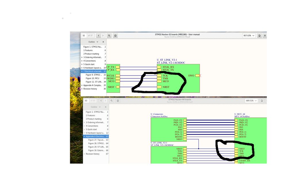

It seems Nucleo-32 boards (as opposed to Nucleo-64 and Nucleo-144 boards) do not support programming external MCUs using their on-board ST-Link.
is it ? here's the schematic I saw
Yeah, the ST-Link is directly connected to the on-bard MCU, without jumpers to route it to a SWD connector.
For example, you can see in Nucleo-64 user manual (see below) there is a section "Using ST-LINK/V2-1 to program and debug an externalSTM32 application". [Click Show More]
https://www.st.com/resource/en/user_manual/dm00105823.pdf
In Nucleo-32 user manual there is no such section.
https://www.st.com/resource/en/user_manual/dm00231744.pdf

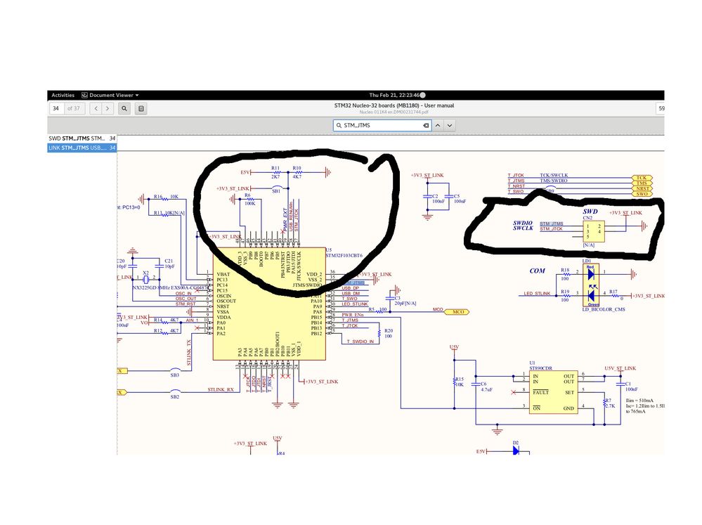

from schematic I can see a possibility using Nucleo 32 for external debugger , any clues ?
antonius
Senior
That's from Nucleo 32 Schematic, I should be able to use SWDIO , SWCLK and NRST for programming external board, if it can not , probably a software compatibility ?? 0690X000006DlIgQAK.jpg
I don't have all Nucleo boards.
But you can still try to cut the PCB tracks, and add your own connector.
Or get another Nucleo board with solder bridges.
