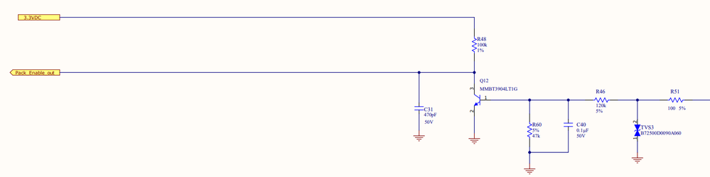

I was not able to use the NJTRST (PB4) pin as a general GPIO input pin. I googled and other people having the same issue using the macro:

  1. I never used JTAG to debug the stm32 before, and I don't recall ever having trouble configuring this particular pin (NJTRST) to be an GPIO input pin. Have I simply been ignorant until now ?
  2. If there is indeed a need to remap this NJTRST pin before using it as an GPIO input pin, how do I do that without the macro mentioned above ?

The pin is configured as an GPIO input, with no pullup/pulldown. I used the CubeMX to generate the driver. On the PCBA, there is an external pullup to 3.3 V. Yet, the pin always read as in the reset state.
0693W000008zQfYQAU.png In the screenshot attached, the Pack_Enable_out is connected to the NJTRST (PB4). The Q12 is in its "OFF" state, yet we are measuring 0V, a reset state at its leg 3.
We program the board through PA13 (SWDIO), PA14 (SWCLK) and the NRST pins.
Thanks for your attention, JW, and please let me know if you need any more information.
Eric

Remove Q12 and measure voltage at NRST again, to exclude errors related to the transistor.

You are right. The Q12 was the issue. Wrong IC was populated as the Q12.
