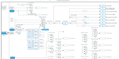

Hello, I have a problem with a STM32L431CC generating a circular PWM burst with the DMA. I am using the Timer1 to generate 4 PWM signals on the Pins PA8, PA9, PA10, PA11. The systemclock of the Timer 1 is 80 MHz. The frequency of the PWM signal should be 20kHz. I have attached the code snipped were i configured the GPIO, Timer and DMA in the software. I get no PWM signal from the GPIO pins. When I manipulate the CCRx registers of the Timer1 with the ST Link debugger, I am able to generate PWM signals with the correct frequency and duty cycle. I suspect that the Timer1 do not make a DMA request and I am not able to find the failure. The DMA do not set any interrupt flags. Also when I manipulate the DMAR register of Timer1, I can see a valid PWM signal.

waclawek.jan
Debug as usually: read out and check/post TIM and DMA registers content.
Where do you set the DMA request selector? I don't understand the Cube/LL gobbledygook.

Thanks a lot for the hint with the DMA request selector. This was missing
