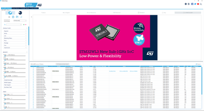

Hello, I am confused in selecting the development board for the microcontroller STM32U585OIY because there are multiple series of it. I am working on a project which uses this name in their schematic STM32U585OIY and I wanted to buy a development board for the same.
Can you please advise me which on I need to buy?

Hello @varun2000 and welcome to the ST Community :smiling_face_with_smiling_eyes:.
There is not any evaluation board that use the STM32U585OIY MCU. If you want to find any MCU adapted to a board, I suggest you use the ST-MCU-FINDER-PC (or on the Phone version) or the version included in CubeMX so you can find the available MCUs and if there is any board that use this MCU:

Thank you for replying.
Can you suggest me an alternative board for the same?
as I said before, there is no boards that use the same MCU or an MCU of the same package. But there is the B-U585I-IOT02A whish use the STM32U585AII6Q as MCU which is different Package (and number of Pins). If you find it useful, you may use it. For a Specific request, contact our local sales and marketing team an FAE.
