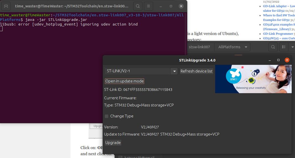

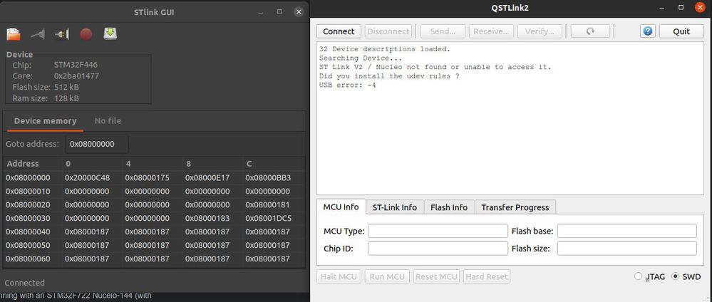

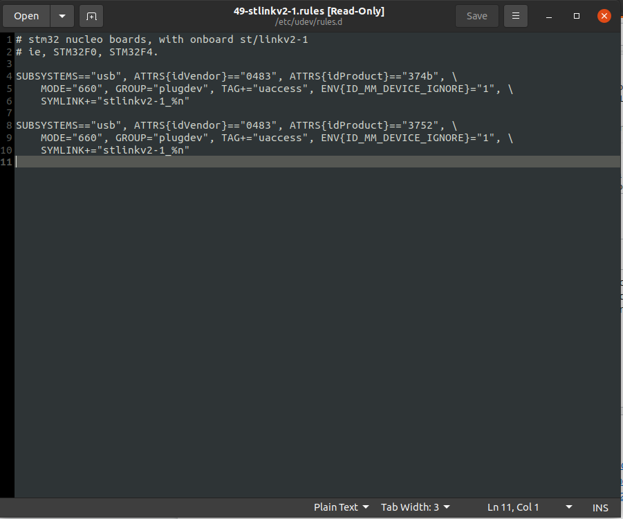

{idVendor} and {idProduct} in /etc/udev/rules.d is difference from these id when i type lsusb in terminal, so i change {idVendor} and {idProduct} in /etc/udev/rules.d to match with id in my lsusb but nothing happend, it still fail. Can you give me a hand?

Hi @NGUYỄN HÙNG​ ,
Are following recommendations provided in RN0093 well applied on your sides?
  • On Linux®, the application relies on libusb-1.0, which must be installed separately. For instance, on Ubuntu®, this is done through the command sudo apt-get install libusb-1.0.
  • On Linux®, users must be granted rights for accessing the ST-LINK USB devices. To do that, it might be necessary to install one of the packages (depending on the Linux® version) provided into AllPlatforms/StlinkRulesFilesForLinux.
-Amel
