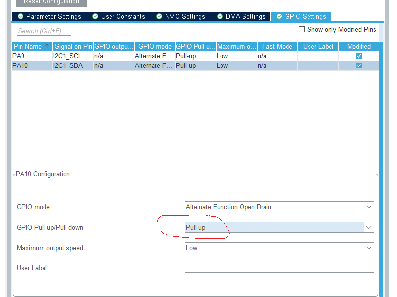

Do you use pull up resistors ? that might be the reason

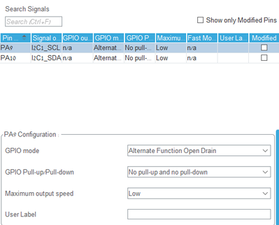

I don't use no pull up resistor. Should I use?
That's really basic to the operation of I2C! Not specific to STM32.
Sounds like you need to do some reading-up on the fundamentals:
https://community.st.com/t5/stm32-mcus-products/i2c-interface-with-adxl345-using-stm32f446re/m-p/658323/highlight/true#M240123
Note that The internal pull-ups are not suitable for use as I2C bus pull-ups - you need to use external pullups.
see examples in CubeMX
you have two boards configured for I2C communication and the pins are pulled up.
those board's pins wouldn't be connected through resistors to 3.3V
Alternatively you can attach 10 K resistors.
see this example from CubeMX
/* Configure SCL Pin as : Alternate function, High Speed, Open drain, Pull up */
LL_GPIO_SetPinMode(GPIOC, LL_GPIO_PIN_0, LL_GPIO_MODE_ALTERNATE);
LL_GPIO_SetAFPin_0_7(GPIOC, LL_GPIO_PIN_0, LL_GPIO_AF_7);
LL_GPIO_SetPinSpeed(GPIOC, LL_GPIO_PIN_0, LL_GPIO_SPEED_FREQ_HIGH);
LL_GPIO_SetPinOutputType(GPIOC, LL_GPIO_PIN_0, LL_GPIO_OUTPUT_OPENDRAIN);
LL_GPIO_SetPinPull(GPIOC, LL_GPIO_PIN_0, LL_GPIO_PULL_UP);
/* Configure SDA Pin as : Alternate function, High Speed, Open drain, Pull up */
LL_GPIO_SetPinMode(GPIOC, LL_GPIO_PIN_1, LL_GPIO_MODE_ALTERNATE);
LL_GPIO_SetAFPin_0_7(GPIOC, LL_GPIO_PIN_1, LL_GPIO_AF_7);
LL_GPIO_SetPinSpeed(GPIOC, LL_GPIO_PIN_1, LL_GPIO_SPEED_FREQ_HIGH);
LL_GPIO_SetPinOutputType(GPIOC, LL_GPIO_PIN_1, LL_GPIO_OUTPUT_OPENDRAIN);
LL_GPIO_SetPinPull(GPIOC, LL_GPIO_PIN_1, LL_GPIO_PULL_UP);
