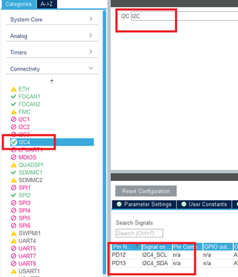

I’m currently working on a project that involves I2C communication using the STM32H750B-DK  but I’m having trouble identifying which I2C peripheral (I2C1, I2C2, etc.) is connected to the Arduino I2C pins (SDA/SCL) on the board.

While working on the configuration using STM32CubeMX, I noticed that PD12 and PD13 are assigned to the I2C4 peripheral. However, according to the user manual and the ARDUINO connectors table (CN2), these pins are listed as I2C1_SCL and I2C1_SDA.
Could you please confirm if this configuration is correct? Is it normal that CubeMX assigns I2C4 to PD12/PD13 while the documentation refers to I2C1 for the same pins?

Now regarding your question about I2C1 or I2C4, and according to the the product datasheet, PD12 and PD13 has I2C4 function. No I2C1 on these pins. So I think it's a typo in the UM2488:
Also in the same user manual / figure 3 it sates that I2C4 is available on the Arduino connector:
I will escalate that for fix. (Internal ticket 206170)

I read that the issue was resolved in an internal version of the user manual, and it will soon be available on the ST website. Could you please clarify whether I can use both I2C1  through the following pins: I2C1_SCL (PB6) and I2C1_SDA (PB7), as per the CubeMX configuration? I just want to confirm if this configuration is possible.

In CubeMx you need to use I2C4:
Rafla
Can I use only I2C4 in CubeMX? I cannot use the other I2Cs even if I clear the pinout?
You cannot use other I2C instances in this board. Look at the CubeMx (the screen shot I've shared) they are marked in red because their IOs are reserved and used by other stuff on the board.
