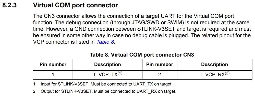

The ST-LINK/V2 doesn't have a USART
The ST-LINK/V3 does, and has a diagram in the manual
For UART programming, check App Note AN2606
Typically want to export RX, TX, NRST, BOOT(0), GND

I looked at the various st-link V3 data sheets, and I still don't see a table that explicitly states "usart Tx ties to this pin".
It may be a terminology problem. These devices only program via the USART.
Which manual were you referring to that has a wiring diagram?

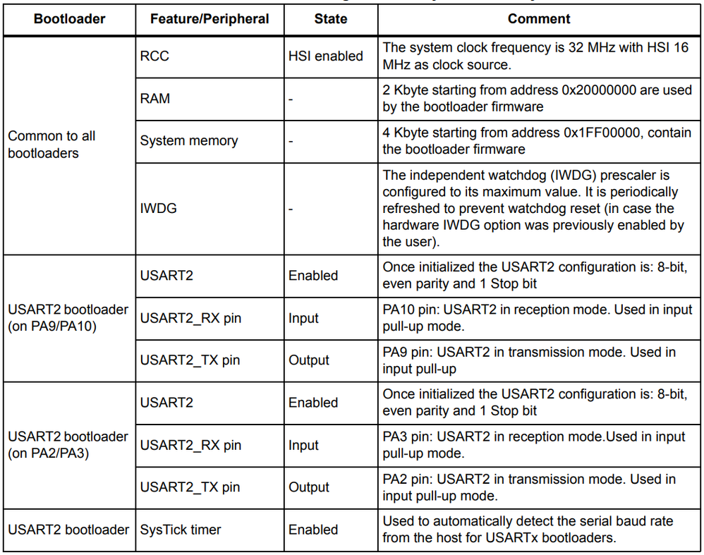

As mentioned by Tesla, you can find in AN2606 STM32 microcontroller system memory boot mode - Application note the hardware resources used by this bootloader.
In section, 54 STM32L01xxx/02xxx devices bootloader, you can find the USART's programming setup.
0693W00000aJkjKQAS.pngHope this helps!

Thanks your your help. I was wondering how to program the processor using the usart, i.e., how to program through the usart rather than through SWD.
I still feel this is poorly documented.
I found a post elsewhere that claimed the cube software will recognize a FTDI USB to serial device. I have not verified this yet, but if it works that answers my question.
