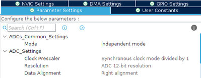

I have a couple of questions regarding the ADC clock on the board in the subject.
What is the default clock speed and where is the clock configured?
All I see in the documentation is that the clock is independent from the AHB clock, but I don't see where it is actually configured.
Also, the ClockPrescaler lets me choose between Synchronous and Asynchronous. What is the difference in this context. Is synchronous referring to the main system clock?

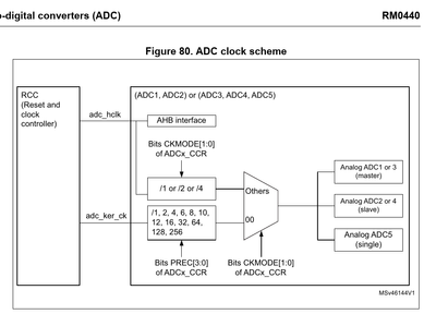

see rm:
Sync = to the AHB bus , its connected to; Async = the ADC clk in clock tree , you can set.
You should see in CubeMX, what you choose. :)
---> read ds, max. clk is there; what you set it then, is up to you - or what you need.

Yes I see that in the manual if I want to get 12 bit resolution, 12.5 clock cycles are required. I also have the sampling time set to 247.5 cycles.
What I am really confused about is this. I have the ADC set to an external trigger at timer 3, which gets triggered every 1 millisecond. Does this mean that the ADC will start a new sample every millisecond, and that it will take 12.5 + 247.5 clock cycles of the ADC_CLOCK to complete 1 conversion? I have the ADC_CLOCK set to 42.5 MHz, so (12.5 + 247.5) * (1/42500000) = 6.12 μsec. So it should take 6.12 μsec to do one conversion every millisecond?
Right - now you understand it . :)
