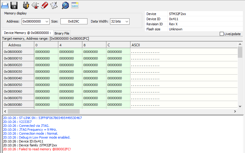

I performed "Target"-> "Connect" of ST-LINK Utility, but an error like an image occurred.

Try to decrease the JTAG frequency from Menu->Target->Settings or /and try to change the Reset Mode from HW to SW.
Check also at Menu-> Target->Option Bytes if Read Out Protection is enabled.
As third option, reconnect device with SWD port to STLink (SWCLK,SWDIO,GND).
if stlink insists to stop reading at 0x080002fc flash address, indicates a HW error.

Thank you for your reply.
I tried JTAG frequency with all patterns. (Reset mode tried with both HW and SW.)
However, the same error screen as the previous one has occurred in all the results.

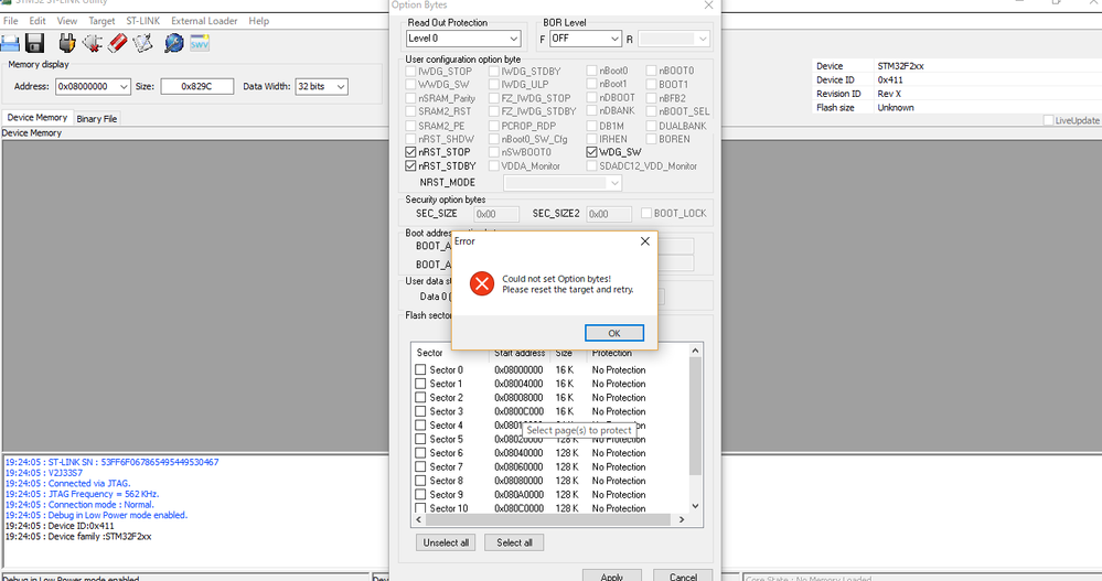

[Option Byte] → [Read Out protection] was set to [Level 1].
I tried to change to [Level 0] but an error occurred. (I think that's because Connect has not been completed.)

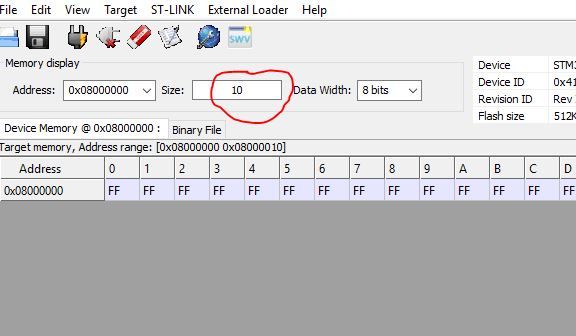

OK. Try not to read so much bytes but change it to eg 16 as below.
After change the RDP or just full erase chip.

However, when I try to change RDP, I get such an error.
