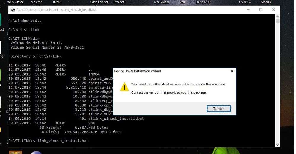

hello dear forum,
I bought a win10 laptop
where I tried to connect st-link/v2 adaptor
I downloaded stsw-link009 package and tried to install
however I get the message
'you have to run 64bit version of DPInst.exe on this computer'
I couldnot find this version in internet
how to proceed ?
please advice
thank you
#st-link #win10

Hello !  Try to change the path of installing directory by make a new folder e.g at root directory ->  c:\abc. Put inside the uncompressed driver  and run it again.
Posted on July 14, 2017 at 13:51
This message is not from bat file.  Is from dpinst_x86.exe.   Try to run  directly with administrator rights the dpinst_amd64.exe

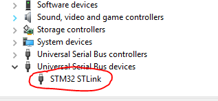

Posted on July 14, 2017 at 14:00
At least try this.
 Go to Control Panel and open Device Manager.
 Find the stlink device(or the unknown usb device)
Right click the device and select properties.
Select Driver tab, then click the Update Driver button.
Choose Browse my computer for driver software.
Let me pick from a list of device drivers on my computer
 Browse for the .inf driver file in your unziped stlink folder. Open and Next.
The driver must be installed.
Posted on July 14, 2017 at 13:40
I have added screenshot
Posted on July 14, 2017 at 15:51
thank you Vangelis, it worked
why there is no readme file in the package ?
It took 3 day of me :(

Posted on October 14, 2017 at 00:28
Hello Simon.
Is STlink visible In windows Device manager?
or is recognized as unknown device?
In first case, driver is Ok.

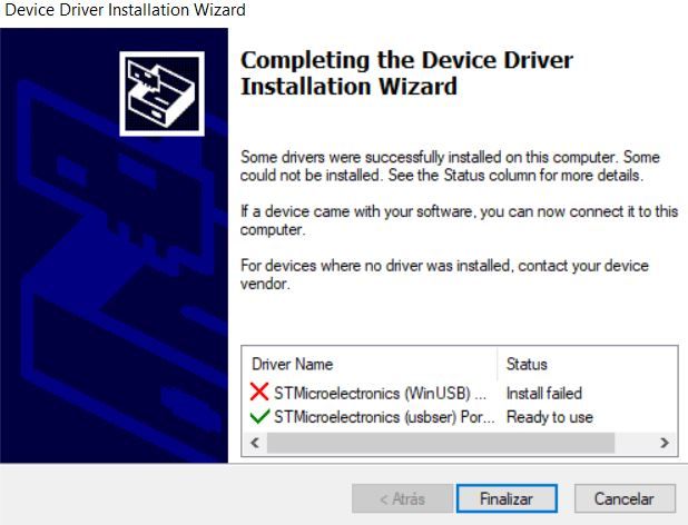

Posted on March 21, 2018 at 19:05
Hi
I?ve tried to follow all the considerations mentioned and still have the same error on my Windows10
a) downloaded
http://www.st.com/en/development-tools/stsw-link009.html
b) unzip and run as with administrator privileges the bat file
c) review Device Manager under unknown usb device and try to upgrade indicating to the .inf folder, it fails with '' Device Description Request Failed''
Any ideas?
Thanks for answering
