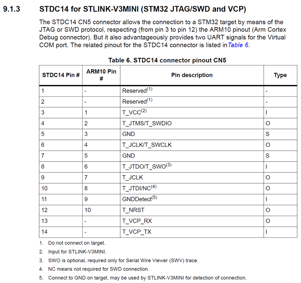

I'm trying to mount STM32L476RGT6U on pcb. I want to upload program using IDE to the controller on the pcb. Please advice me the suitable connection diagram to fullfill this particular requirement.​

For direct connect exist internal bootloader and around five usable buses (USB,UART,I2C,SPI...). Read bootloader docs.
Simpler is use SWD interface for debug and load code. But here you need next hw to provide stlink IF.
Diagram here is simple for basic designs two wires and gnd .
Make it easy on yourself and use a standard connector used by the programmer of your choice.

So what is it uses ? Like should I connect my pcb mounted MCU with this and thorough this to pc ? If so, what should be it's connection ? How STM32L476RGT6U should be connected to this ?
Please help me a bit more on how to use it ?
Or should I mount this ​stlink V3 mini on pcb itself with MCU ?

The debug interface mainly needs connectivity of SWDIO and SWCLK pins, the NRST and SWO pins are also very helpful.
Most would use a header connector, and then a cable to the debug pod
Put a 14-pin header on your board and connect the signals in the table to the relevant pins on your board. For example, T_SWO is the SWO of the target MCU, which is pin PB3 on your board. T_VCC should connect to the power rail on your board. Note that you will still need to provide the board power.
