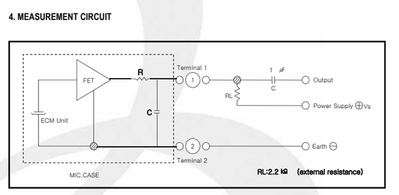

I am not a pro user of using stm32 microcontrollers and i need to know if it is possible to connect an electret microphone with a stm32 nucleo h743zi board and see any information i receive with this component.
For example, i want to connect the condenser mic with nucleo board and see in my screen any data, or something to prove that i am connecting this correctly or know how to treat with these type of components.
This photo shows the type of condenser microphone i am using.
Sorry if i am not explaining it so well because i don't know if it is possible to do things like i am asking here.
Thank you so much for your time.

Yes, you can do that.
BUT...
1) Audio signal quality will be much worse than nowadays audio standard, due to the STM's 12-bit SAR ADC (or 16-bit?).
2) it's a loooong and hard way from having the components to actually getting any usable data to your PC.
Depending on your knowledge / skill level, this can take from 2 weeks (HW & STM pro with USB knowledge) up to several months.
3) Something many people forget: you need some software on the PC side as well.

2) Okay, you could start by connecting a 3.3 V electret to the STM ADC. Quite simple, the microphone datasheet basically shows how to do that.
3) I mean how to work with "audio data".
If it's your own simple data stream (e.g., USB virtual comport), you need to handle that on the PC side with some self-made software.
If you make your STM32 look like a USB audio device, PC side gets simpler, but STM32 side will be much harder.
