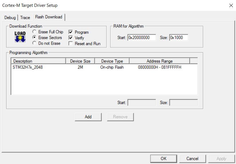

Go into the Flash settings and switch between the H7 Single/Dual bank algorithm, and make sure the algo is for the 0x08000000 memory space.

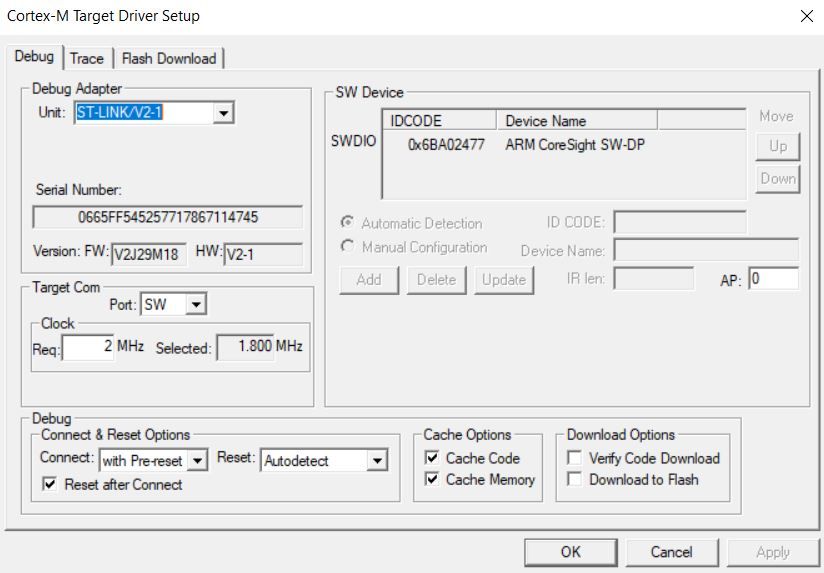

Thank you. Please see the following setting. What do you think is the problem?0690X00000As3qcQAB.jpg
I'd start by updating the ST-LINK firmware V2J35 is more current
