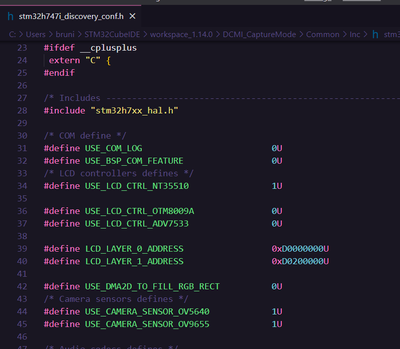

    I'm completely new to stm32, I really appreciate your help! I have checked the wiki that you mentioned before to add drivers. I modified the stm32h747i_discovery_conf.h file like the black box below, but it doesn't work (I don't know if this is what are you trying to say). Also, when I disable the OTM8009A, I have several issues in other parts like OTM8009A_480X800 undeclared and I don't know if I have to change all this parts to NT35510.
    #include "stm32h7xx_hal.h"
    /* COM define */
    #define USE_COM_LOG 1U
    #define USE_BSP_COM_FEATURE 1U
    /* LCD controllers defines */
    #define USE_LCD_CTRL_OTM8009A 0U
    #define USE_LCD_CTRL_NT35510 1U
    #define USE_LCD_CTRL_ADV7533 0U
    #define LCD_LAYER_0_ADDRESS 0xD0000000U
    #define LCD_LAYER_1_ADDRESS 0xD0200000U
    KDJEM.1

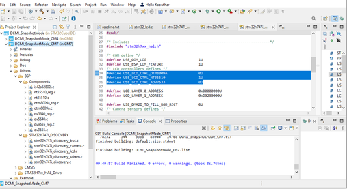

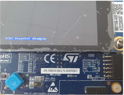

    For that, I tested the DCMI_SnapshotMode example with MB1248-H747I-D03 and LCD is MB1166-A09 using the STM32CubeIDE1.14.0 version and it works correctly.
    Could you please follow these steps:
    1-Dowlownd the STM32CubeH7 from this link and Unzip the file.
    2-Go on the GitHub STM32H747I-DISCO BSP website, and download as zip. Unzip the files and copy them in the project folder STM32Cube\Repository\STM32Cube_FW_H7_V1.11.1\Drivers\BSP\STM32H747I-DISCO by replacing the old files.
    3-Download the OTM8009A LCD drivers on GitHub and place the unzipped files inside the folder STM32Cube\Repository\STM32Cube_FW_H7_V1.11.1\Drivers\BSP\Components\otm8009a by replacing the old files.
    4-Create a new "nt35510" folder in \STM32Cube\Repository\STM32Cube_FW_H7_V1.11.1\Drivers\BSP\Components
    5- Download the NT35510 LCD drivers on GitHub,  and unzipped and copy the files in "stm32-nt35510-main" folder to \STM32Cube\Repository\STM32Cube_FW_H7_V1.11.1\Drivers\BSP\Components\nt35510.
    6- Open DCMI_SnapshotMode example with STM32CubeIDE1.14.0 version STM32Cube\Repository\STM32Cube_FW_H7_V1.11.1\Projects\STM32H747I-DISCO\Examples\DCMI\DCMI_SnapshotMode\STM32CubeIDE
    7- Add "nt35510.c" and "nt35510_reg.c" files to the STM32CubeIDE project. So, drag and drop the nt35510.c and nt35510_reg.c files in STM32CubeIDE from STM32Cube\Repository\STM32Cube_FW_H7_V1.11.1\Drivers\BSP\Components\nt35510 as shown in the below figure:

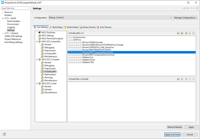

    8-Add the STM32Cube\Repository\STM32Cube_FW_H7_V1.11.1\Drivers\BSP\Components\nt35510 folder to the include paths, so, click on Project->Properties and follow the instructions below:
    I add in attachment the DCMI_SnapshotMode project after all modification.
    I hope this help you!
    Thank you.
    Kaouthar

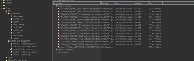

    I have to thank you again to explain it to me but isn't work. I followed all the steps you mentioned and when I modified the stm32h747i_discovery_conf.h file, I have the same issue that I mentioned before. This is the error that shows on my console:
    This is due the OTM8009A deactivation onstm32h747i_discovery_conf.h file, as shown in the below:
    Even if I activate nt35510 and otm8009a, it displays only noise in the LCD.

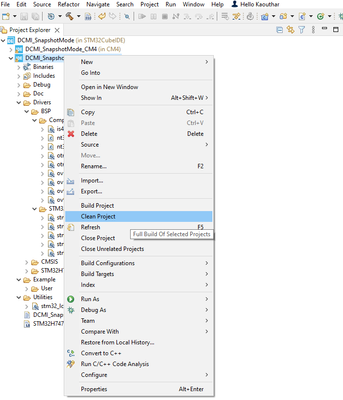

    Could you please try to "Clean Project" before "Build Project".
    I disabled the OTM8009A and I didn't reproduced the issue.
    Please make sure that Step2 is set correctly.
    Please try to:
    - Download the project in attachment and unzipped.
    - Open STM32CubeDCMI_Example\STM32Cube_FW_H7_V1.11.1\Projects\STM32H747I-DISCO\Examples\DCMI\DCMI_SnapshotMode\STM32CubeIDE project.
    -Clean Project
    -Built Project.
    Please let me know if the issue is solved.
    Thank you.
    Kaouthar
