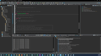

HardFault_Handler() at stm32f0xx_it.c occur when i run a project with RTOS.
Dai Huy
Dear STM support team.
My name is Dai. I am working at G-innovation Corporation.
Now I have a project using the STM Chip(STM32F0xx).
I use the STM32CubeMX (version 6.11.0) to create a project using the STM32F091VBT6 with CMIS_RTOS.
this project aims to study all CMSIS-RTOS APIs.
the function of the project include:
- 6 thread: "idle thread" to blink an LED at 0.5Hz.
              "SWI thread: is reserved.
             "dut1 thread" to send counter log to the PC over UART1, "dut2 thread", "dut3 thread" and "dut4 thread" as the same "dut1 thread".
             mutex to protect the "debug_printf" function.
I received a "HardFault_Handler() at stm32f0xx_it.c 0x80033f4" after running it for several milliseconds.
I have attached my project, the UART log, and the Debug log to this post.
everybody helps me to debug and fix this bug.

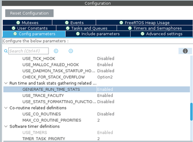

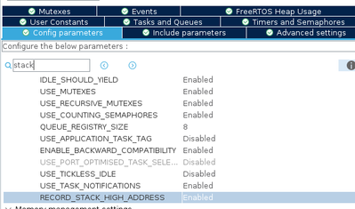

There are a couple of things you can do. The first step is:
Click the button here.
Then additionally you can go into freeRTOS settings and enable a few things.
1. Generate Runtime Stats.
2. Check for stack overflow. (This hook has saved me so much headaches over the years)
3. Also enable stack high address.
Don't ask me about the runtime %. No idea :) Never used it.
EDIT: You need to set a break point somewhere in your code to see the stats being updated.

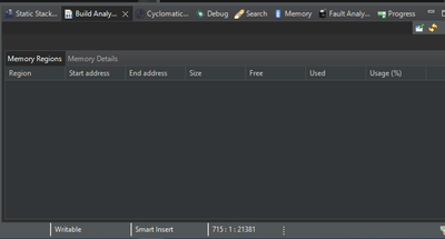

I have a new problem.
the "Build Analysis" windows of the STM32CubeIde show nothing. how do I get information about my build?
Regards
Dai Huy
Please open a new thread for this new question.
Thank you for your understanding.
