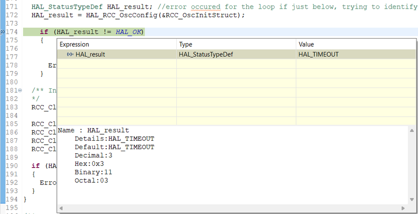

Hello everyone,
I am configuring an STM32F401RE and its RTC on the STM32CubeIDE software
I've written an program that debug without errors. But ErrorHandler() is called during the RCC Oscillators initialization (during the "SystemClock_Config(void)" process).
I think i'have followed the steps and the right parameters, but would you have a clue of where could it be from ? Let me know if you need additional pictores of the system configuration of the .ioc file maybe
 RCC_OscInitStruct.OscillatorType = RCC_OSCILLATORTYPE_HSI|RCC_OSCILLATORTYPE_LSE;
 RCC_OscInitStruct.LSEState = RCC_LSE_ON;
 RCC_OscInitStruct.PLL.PLLSource = RCC_PLLSOURCE_HSI;
 RCC_OscInitStruct.PLL.PLLM = 16;
 RCC_OscInitStruct.PLL.PLLN = 336;
 RCC_OscInitStruct.PLL.PLLP = RCC_PLLP_DIV4;
 RCC_OscInitStruct.PLL.PLLQ = 7;
 Error_Handler(); //the call of ErrorHandler() happens here

@willow wrote:
it has previous user and uses
So a previous user might have modifies and/or broken it ...
@willow wrote:
but always for my project purpose
So is this a school class/lab setup?
If so, get your teacher/supervisor to check the board and your work ...
And of course i have a screen that is meant to display the hour, but this one is only displaying black squares, i suppose this is related
I am currently working in a company and this is a test borad we have to try all the programs before implent them IRL, so I don't have any teacher or supervisor to check on me :(
Do you not have colleagues who could help?
