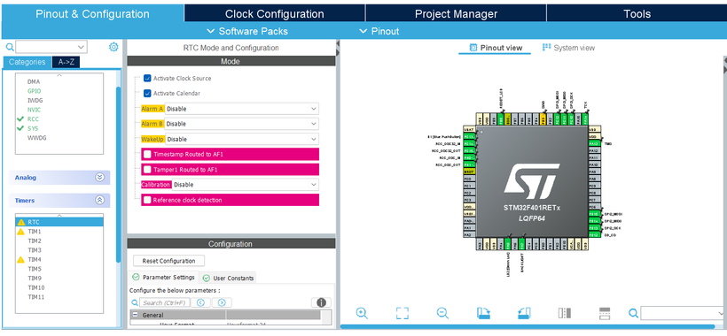

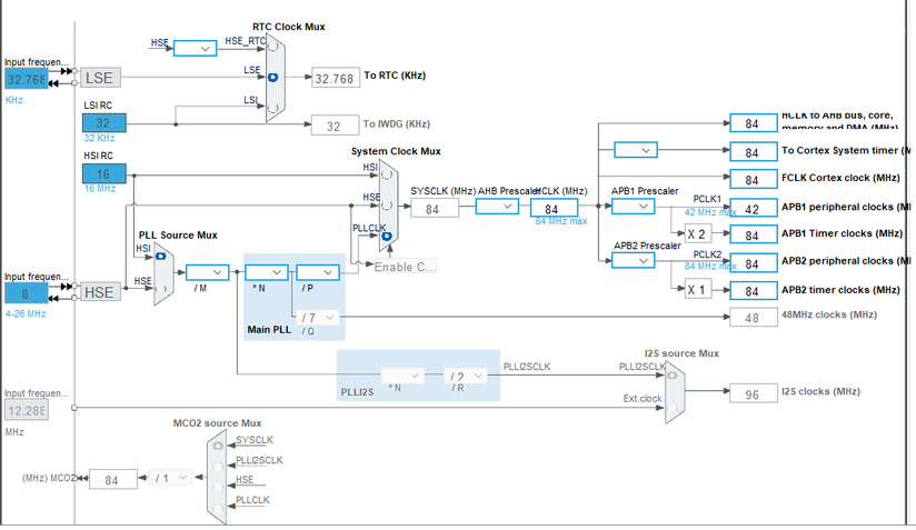

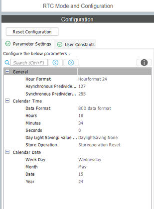

I think i'have followed the steps and the right parameters, but would you have a clue of where could it be from ? Let me know if you need additional pictores of the system configuration of the .ioc file maybe
 RCC_OscInitStruct.OscillatorType = RCC_OSCILLATORTYPE_HSI|RCC_OSCILLATORTYPE_LSE;
 RCC_OscInitStruct.LSEState = RCC_LSE_ON;
 RCC_OscInitStruct.PLL.PLLSource = RCC_PLLSOURCE_HSI;
 RCC_OscInitStruct.PLL.PLLM = 16;
 RCC_OscInitStruct.PLL.PLLN = 336;
 RCC_OscInitStruct.PLL.PLLP = RCC_PLLP_DIV4;
 RCC_OscInitStruct.PLL.PLLQ = 7;

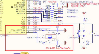

I didn't reproduce the behavior with NUCLEO-F401 board. Could you confirm you're using that board?
Also did you modify something on it? especially LSE part of the board?

Could you please share your ioc file?
Of course @mƎALLEm and thank you for your answer, here is my .ioc file attached

@willow is it a brand new board, straight from the factory, or has it had previous users and/or uses ?
Check especially that part of the board:
