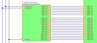

ADC and TIM/PWM pins would likely be exposed via the Arduino Shield connector. Check the board User Manuals, and Schematic (under CAD Resources). Pin level functionality can be found in the STM32H747 Data Sheet
Thank you so much for your swift response.
You mean the following connection:
