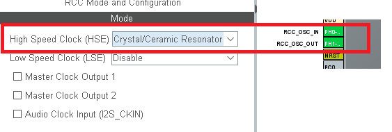

‎2023-05-20 3:44 AM - edited ‎2023-11-20 7:34 AM
>if you remove/de-solder R68 (= disconnect MCO ), X2 + F407 set to external clock are the 8MHz source then.
X2 does not generate a signal after the MCO disappears.
I checked with an oscilloscope, there is no 8 megahertz signal on PH0-OSC_IN.
>also on my F407 board LSE , 32kHz crystal, is fitted, but in diagram is marked as "not fitted" .
On my motherboard X2 is installed.
‎2023-05-20 3:57 AM
ok, now set F407 to "crystal..." , ok. Then it will work !
but energy is low, so you cannot go with any probe to crystal - you stop it with the probe !
just probe at 10:1 , low capacity, can (maybe!) see oscillation on osc-out pin. try.
on osc-in you will probably see "nothing" , probe stops oscillation.
to check it right way: enable MCO on F407 and then check with probe (10:1 setting always ! ) on mco pin - there you see it...

‎2023-05-20 5:24 AM - edited ‎2023-11-20 7:35 AM
this looks like HSE is set to "bypass" .
shure, you have set it to "crystal.." and load /debug then ? and use MCO setting !
see circuit of dev-E board , F407 black board:
so add 500k ... 1 meg resistor in par. to crystal !

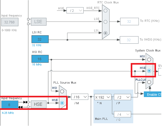

‎2023-05-20 2:21 PM
I have another question on the same topic.
HSE is formed by a crystal and is equal to 8 megahertz.
HSI is formed inside the STM32F407 microcontroller and is equal to 16 MHz.
Are there settings for the 8 MHz MCO signal that comes from ST Link? (I know that this frequency is unchangeable, maybe some other settings, for example, setting MCO 8 MHz from ST Link as a clock source.)
Or is ST Link's 8 MHz MCO just a fallback for HSE?
There are no separate settings for MCO 8 MHz from ST Link? STM32F407 microcontroller sees MCO 8 MHz from ST Link as HSE?
‎2023-05-21 3:11 AM
no. except you set in clock settings an external 8M clock.
no. is cheap standard clock on most nucleo boards, because stlink anyway there.
no.
yes. is same as external clock oscillator for F407 ; can use the "bypass" clock setting.
(you have changed this, now F407 on his own crystal clock. )
