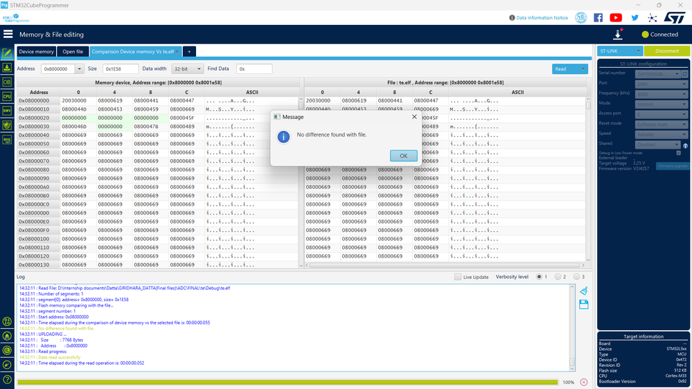

How are you sure the program is erased? did you check the flash content with STM32CubeProgrammer for example?
It's physically erased or doesn't appear to run?
Show memory space with STM32 Cube Programmer.
Use tool to write.
Check code build address and SCB->VTOR settings.
Have Error_Handler() and HardFault_Handler() outputting actionable information.

No Sorry, I had not checked with the stm32cube programmer before.
Now I did, I compared the memory with the .elf file. It turns out the program is not getting erased but it is just not executing the program.
I'm just running the blink LED program to debug the error.
No I'm sorry It's not getting erased physically..Screenshot 2024-04-01 143229.png
As you said the program is not starting after the power off and on.

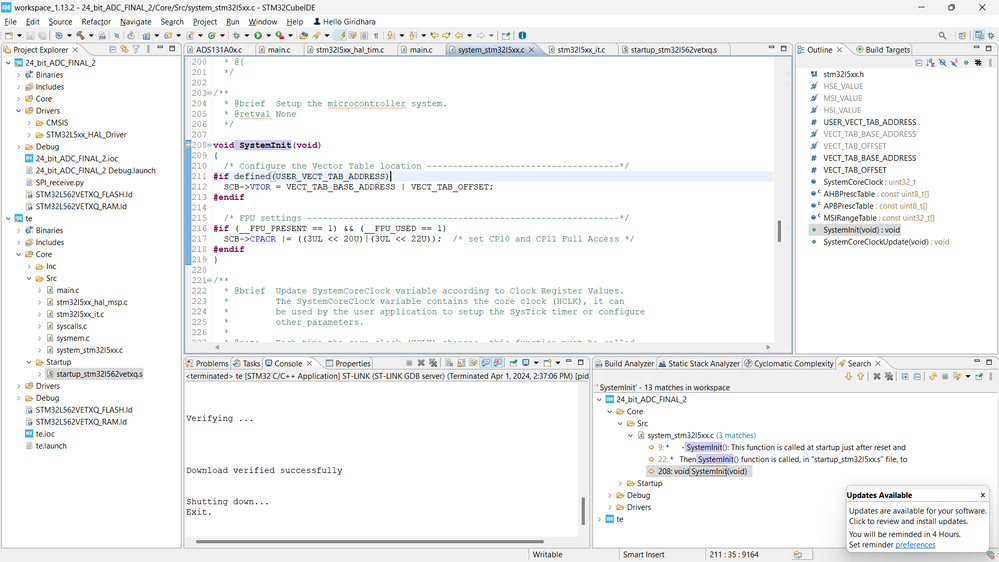

Here is the SCB->VTOR value:
Where
VECT_TAB_BASE_ADDRESS = (0x08000000UL)
and
VECT_TAB_OFFSET = 0x00000000U

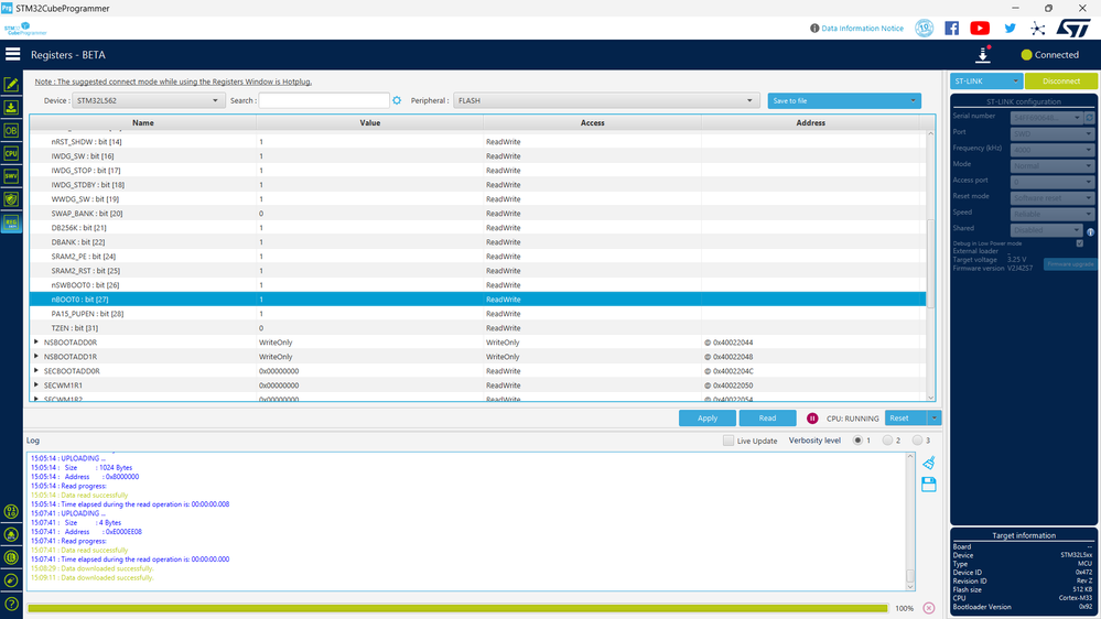

Check the boot configuration and boot pin
I tired to make it Zero and run again
but it's going back to HIGH state again
